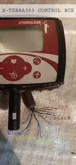

So I have a minelab x-terra 305 and really need to figure out how to hard-wire the coil to the control box...I have no idea which wires go where because the male and female connections have been removed (long story)...I'll try to attach some pics so you can understand my dilemma better...but basically the control box has 6 wires (blue, red, yellow, black, grey, green) but the coil has 8 (brown, brown/white, blue, blue/white, green, green/white, yellow, yellow/white)...I have hunted the internet and the only thing I can find is which color wire from the control box goes to each pin on the connector
pin 1 Blue
pin 2 yellow
pin 3 green
pin 4 Black
pin 5 red
pin 6 grey
But that doesn't exactly help me much...here are a couple pics...i hope I've explained everything ok....let me know if you have any questions for me...thanks so much in advance!

Found this old post on another forum...
Try calling Minelab's nearest repair center, and ask to talk to a tech.
Key at the top counting clockwise with 6 being the middle pin..
1 Blue
2 Yellow
3 Green
4 Black
5 Red
6 Gray
Thanks for the support from the forum and marty from minelab tec.
I was going to suggest you call Minelab too. I had talked to Marty years ago and he was very helpful!
I was going to suggest you call Minelab.
Ya I emailed them and that's how I got the only info I have regarding the pin and wire arrangement for one side....but I haven't heard back about the wire placement for the other side yet...

I was not belittling anyone, I was LOL and replying to SD51's comment because I was the Marty he was referring to at Minelab, I was the tech he called at Minelab.
I no longer have the documents for wiring to the motherboard. Why don't you just send it to the Minelab repair center?
I have reached out to a friend to see if he has the motherboard side wiring schematic, he worked for Minelab as well.

Yes it was me, worked for their repair center for almost 5 years.

You are fine, you didn't know and I didn't quote SD51 so it is mostly my fault.
I will let you know when I hear back from my friend, he has to go to his storage unit and see if he still has an XTerra, if he does he will open it up and get the wiring schematic.
