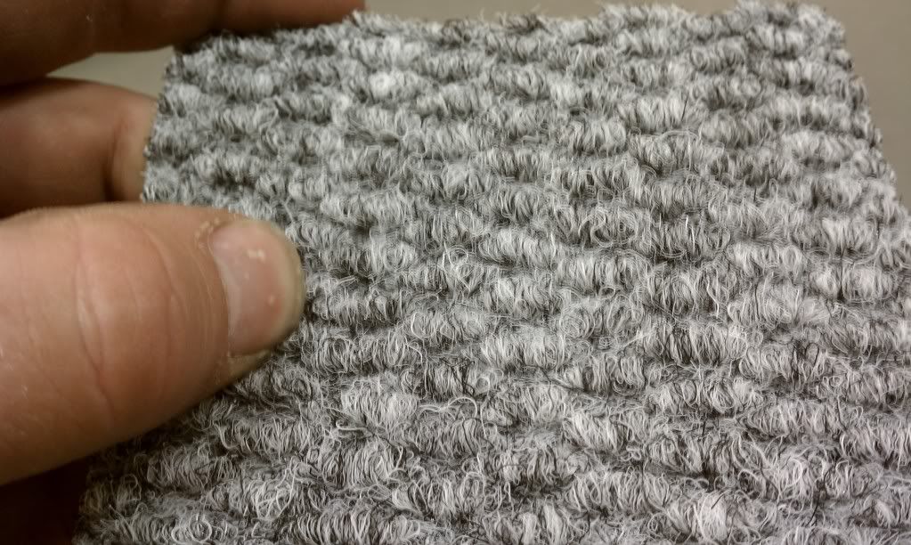

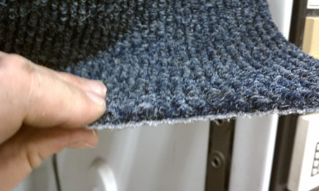

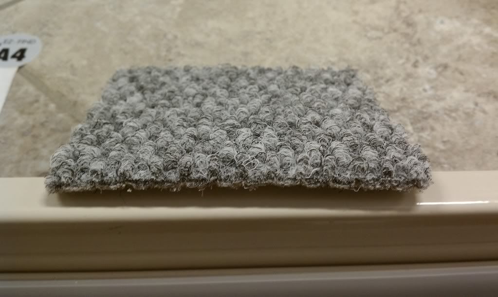

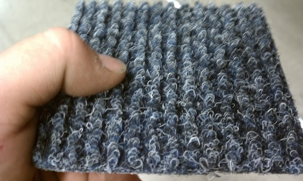

Well, I took a look around lowes and home depot today while getting stuff for my foot valve and came across these carpets.
This was at lowes for 69c a sq ft. I was surprised at how well the rifles looked and it looks like it would hold gold well.
This was at home depot. Looks a bit like the shaw carpet posted above. It is 68c a sq ft.
I still need drop by my local carpet store and see about that shaw carpet
