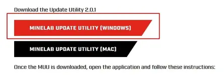

Note that there are two links to the update program. One of them does not have the .exe file extension for the Windows version that is necessary for Windows to know that it is an executable program. Instead, Windows will simply ask you what to open it with (and there is no answer to that question).
As of this morning, at least, this one (in the red box) does not work right.

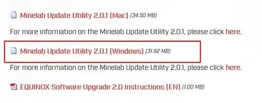

Good possibility that ML will fix it soon, but for now, avoid that page and use this page instead
https://www.minelab.com/equinox-software-update-2-0.

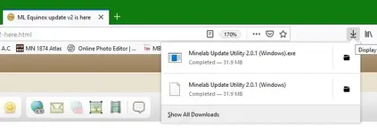

You can see here that the first entry in my browser's Download tab is missing the .exe. The 2nd entry (the top one) is the correct one

After cursing for an hour this morning because I couldn’t get it to load I gave up. Found the other link after work. Set it up and used it tonight. Found a toe ring at the beach and some clad.
