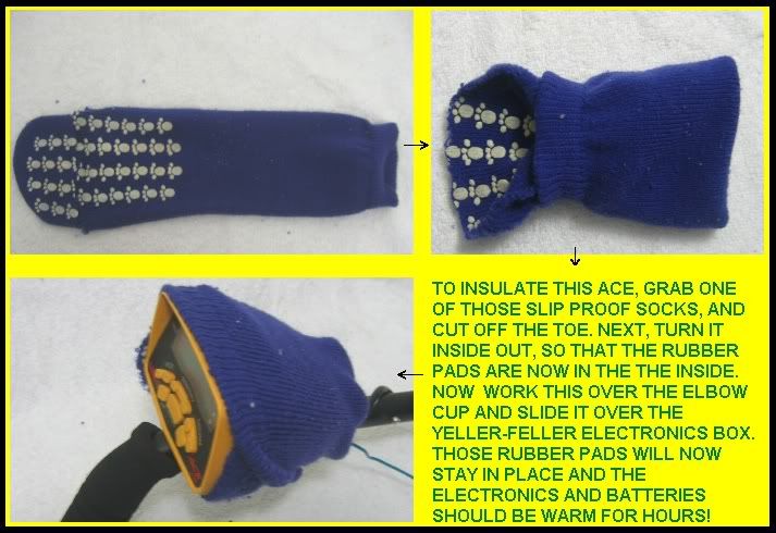

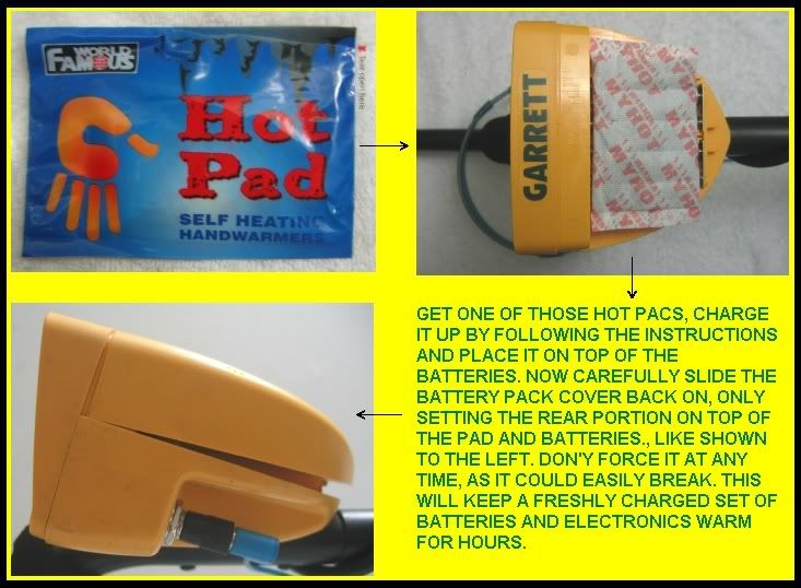

I have been hunting in the winter months for many years. The problems usually are with the batteries running low quickly. I have hunted in temps down to about -25c/-13f. The curly aspect of the headset wire loses it's springing qualities and gets very stiff. I sometimes attach hot pacs to the electronics to keep the batteries warm also.

Great ideas john. I'm planning on doing some site testing for this spring and will give that a try for the at pro.
I did the hot pac a little differently, but it's simpler as the batteries are inserted in a totally different way.

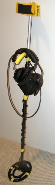

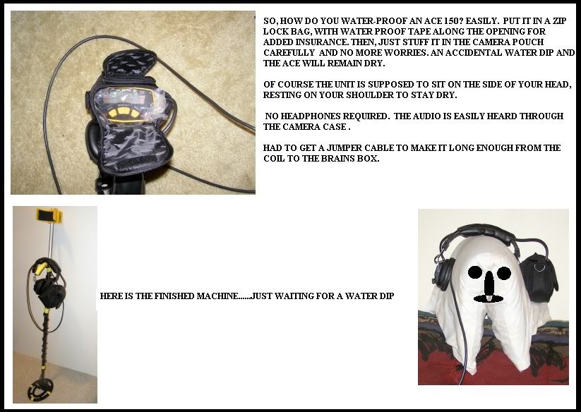

I noticed John that you have a converted Ace 150 as a water proof machine. Just wondering if you could send me some info or specs/pics on your modification. I'm thinking if water proffing a tesoro compadre or an Ace myself. Thanks.
That is funny john but very clever, nice idea
I noticed John that you have a converted Ace 150 as a water proof machine. Just wondering if you could send me some info or specs/pics on your modification. I'm thinking if water proofing a Tesoro Compadre or an Ace myself. Thanks.
Basically what I did, was extend the coil wire (I ordered and extension) and removed the electronics from the upper stem. I then attached it to replace one side of an old headset as shown. I wrapped the machine in plastic as assurance in case it got dunked!
