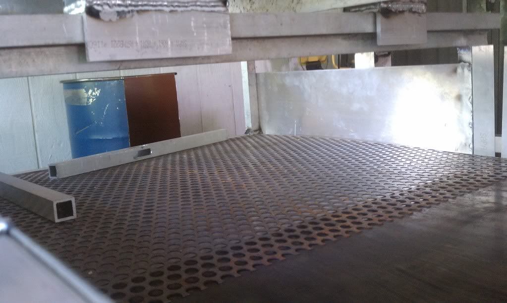

I think I will cut up the flare I have. Make it about 5' long, and widen to 32". If I set it at a steep enough angle it should slow the material down and also settle the heaviest before going over the 2" long classifier.

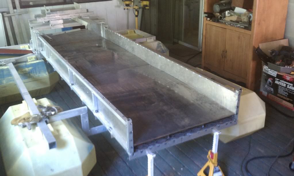

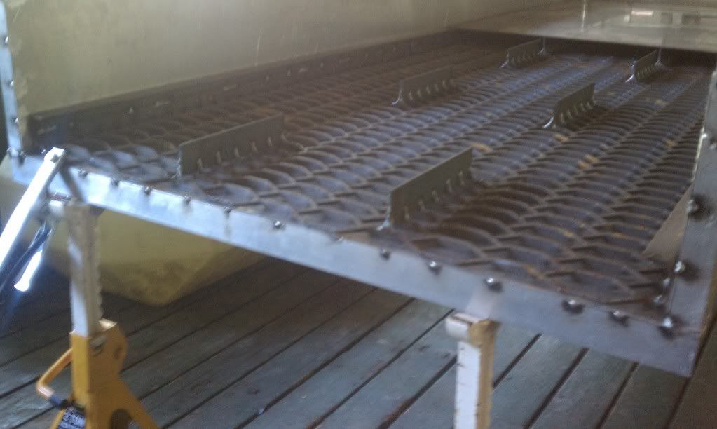

Also, I will have the over under sluice just about done today and will post pictures later. I might even get the flare cut up today.

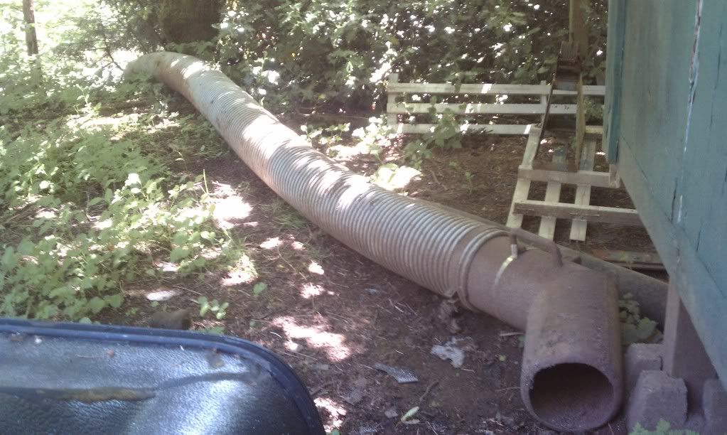

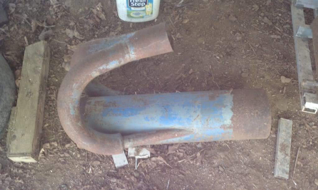

Random picture of my stiff hose and nozzle.
Does anyone know if this is an original precision jet?
