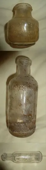

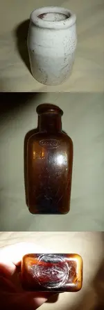

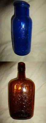

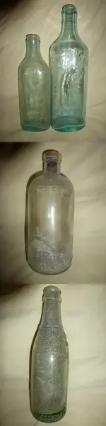

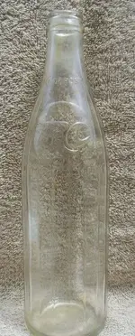

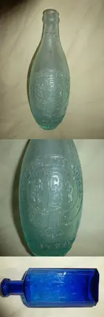

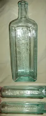

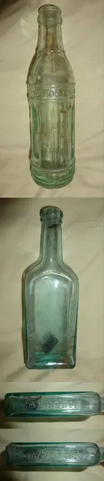

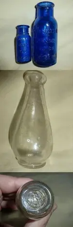

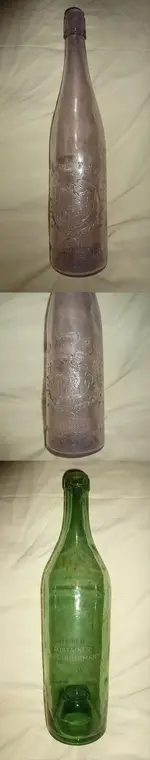

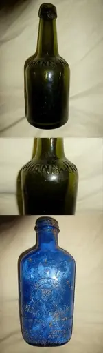

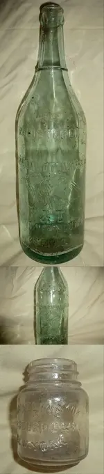

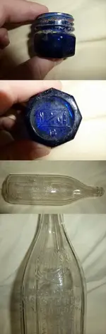

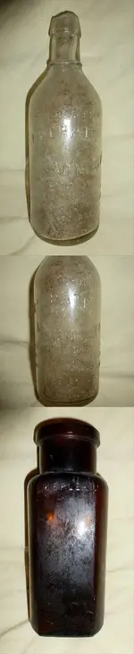

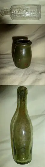

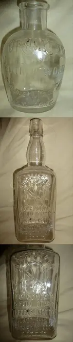

This is a small part of my dads bottling collection, my mom made him get rid of most of it after they retired and moved to FL :'(. I will be taking photos of his MDing finds as well and posting them as well. Any help at all will be greatly appreciated, any cleaning tips, Identification, and if any of them have any value at all. :help: Most of these were found after a house was excavated upstate NY. He has been MDing for 30 plus years and I have learned a lot, lets hope with practice it can become as easy as he makes it look :thumbsup: Anyway enjoy the bottle pictures, hope I didn't mess up the re-sizing of them, well I think my brain is broken from all the cutting cropping and pasting with these photos I am just gonna post and see how it goes, also if anyone has any quick tips for photo editing on here would be greatly appreciated as well, Thanks All! :hello:

Many are just common with no value unless you like looking at them in the window with the sun shining thru them. There are a handful that may have some value but it's hard to read the embossing, it would be best to take pic's with light behind them so the embossing can be clearly read. I look forward to seeing them that way..... Jim
The first bottle shown has potential, the tooth powder has potential, Theodore Nettes Whiskey, Bowling Pin shaped, blue bottle below the bowling pin, and the Harrisonburg clear med all have a bit of potential to have some value and could use better natural light pic's so the embossing can be read clearly......Jim
MayheM ~
Overall I'd say you did real good with the pictures. You should see some of the stuff posted on other forums. Nightmareville! :laughing7:
I especially like the "New York Bottling Works" torpedo/bowling pin style bottle. Most of those styles are from Europe. Plus it's a crown cap too. Nice bottle. Could you please write out everything that is embossed on it? I may be able to date it for you. But even without the info, I'd circa date it to around 1905.

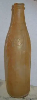

You asked about cleaning methods ... lots of options there. If you are into household products, I recommend soaking them overnight, especially the rust stained ones, in undiluted distilled white vinegar, followed by a good detergent scrubbing inside and out. The white vinegar eats rust and is good for carpet stains as well.
Or if you prefer something stronger, I suggest "Bar Keepers Friend." It works great!
The first four pictures are the before and after results of a RC Cola bottle I recently cleaned using just the distilled white vinegar. The last picture is of the "Bar Keepers Friend."

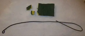

Whatever residue is left I remove with a home-made brush. I use a stiff wire coat-hanger for this purpose. I cut the hook portion away. I bend the smallest possible loop on one end of the wine and a large loop on the other. The larger loop will be the handle.
I cut a lengthwise strip of scrubbing pad (a Scotch-Brite knockoff from the dollar store) wide enough to generously cover the small loop. I roll the strip of scrubbing pad around the small loop and secure it tightly with several wraps of thin copper wire. String or a rubber band could be substituted for the copper wire. The copper is too soft to scratch the glass, but is relatively impervious to chemicals.
If you wish to use a commercial bottle brush, try this. I affix a small patch (about the size of the brush diameter) of scrubbing pad to the tip of the brush using polyurethane cement (Plumbers Goop, Shoe Goop, etc.). This patch not only makes the brush more effective in corners and at the bottom of the bottle, it also cushions the tip of the wire brush from any "hammer effect" in manipulating the brush inside the bottle.

could you take better pics of the 2 bromo bottles? I think there may be a backwards Z on one or both
