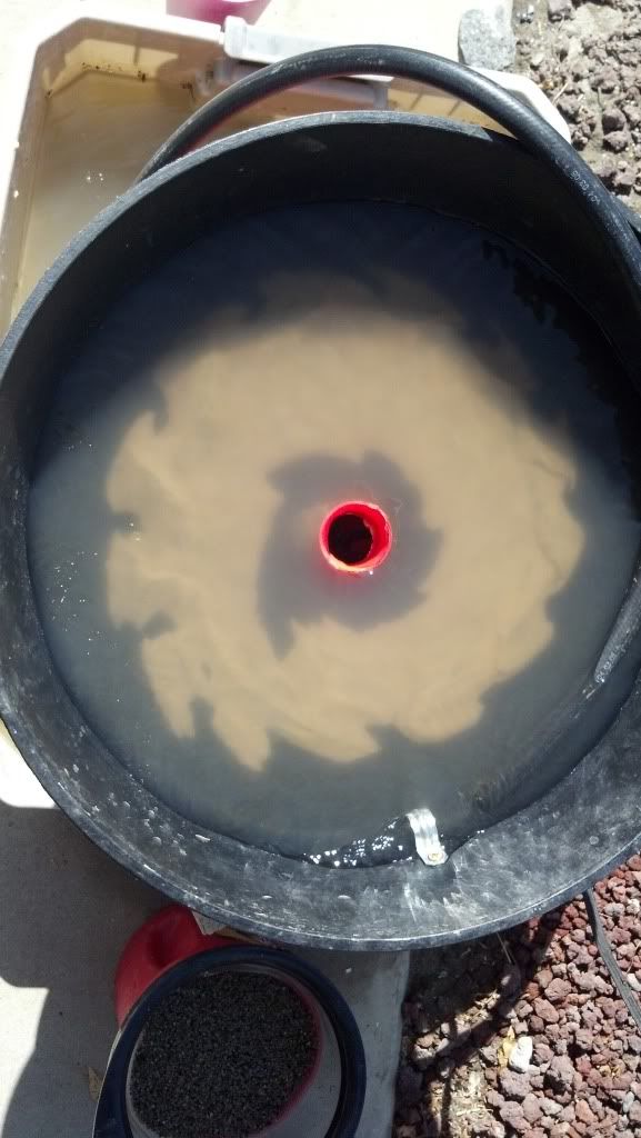

I can't seem to find any big gold so I thought I would practice on finding the smaller stuff that we all know is there but is a pain in the but to collect it...
The material is made from a non slip rubber so any gold in there will cling to the bottom. This is a pic of my first run, 2 scoops that was classified through 50 mesh. It's a slow process but it seemed to work really well when I ran a small amount that was classified through an 1/8 classifier.

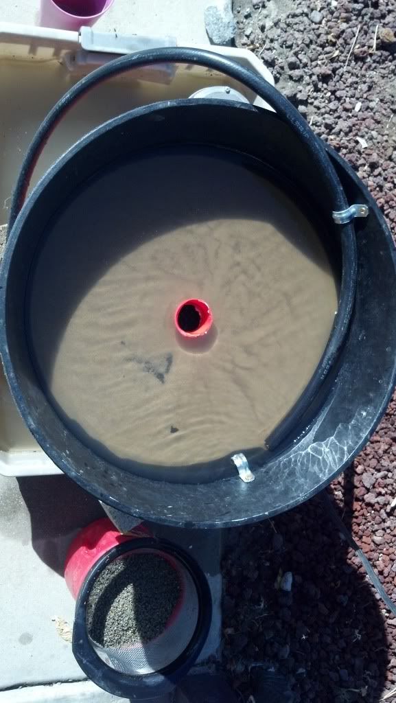

After an hour of running my new bowel...Looks like it's starting to clean up nicely...

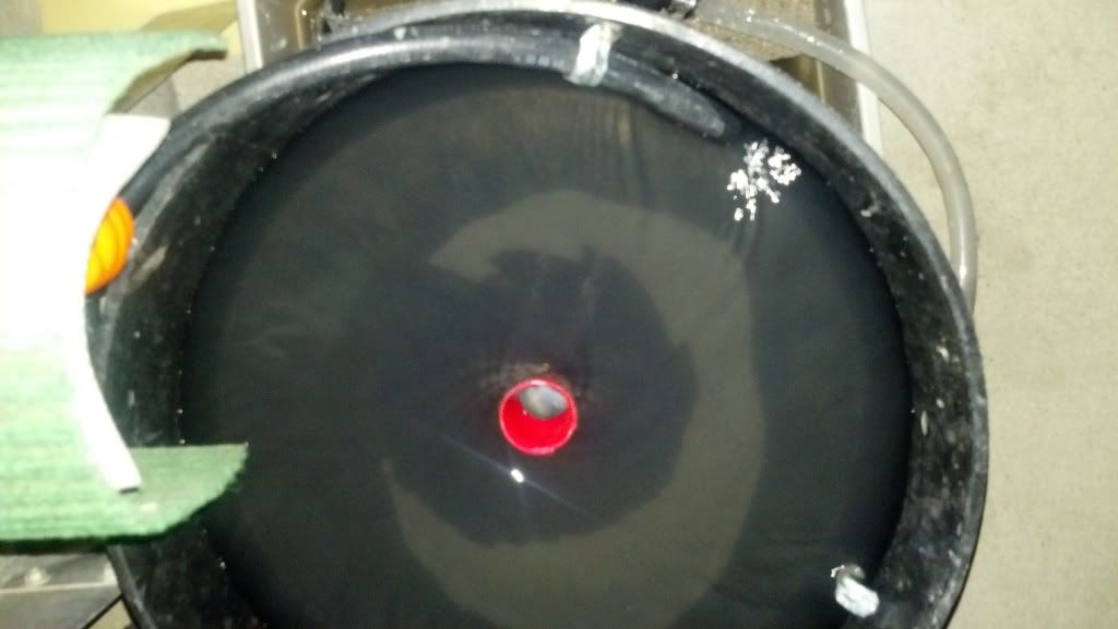

Well it's all down to black sand only... I have it fine tuned to where its slowly peeling a small layer of black sand off. I know this process can take a while but I am finding it an obsession to find the the fine gold...

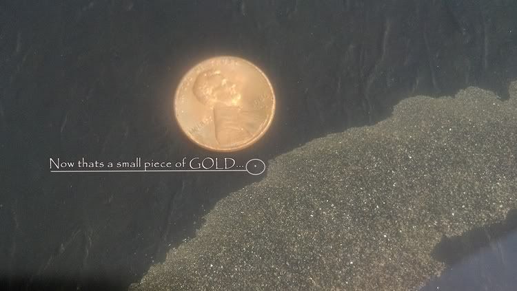

I would say my little black bowel is working pretty good.... The smallest piece of gold I have yet to find myself....
