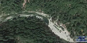

This is a pic of the swimming hole. I dredged all around the edges getting fines, pickers, and small nuggets. The max depth I could reach was 12-15 feet, even
with a jerry-rigged extender hose. The gut of the hole is probably 30 ft to bedrock. I'm convinced there is around 100 ozs laying deep in the hole, and if by
some miracle big, powerful dredges are allowed again, i'll find a way to get to the bottom. Then its off to Aruba!
The hole is about 40 yards long by 25 yds wide, and 15 ft to top of gravel at deepest part. There are three hydraulic mines
upstream and an ancient river channel crossed 2 miles upriver. At least 4 hard rock mines are farther up too.
Just to the right of blue barrels, at five feet down, is the top of a man made pole verticle in the gravel, which says to me its the
end of a long tom emptying into the pool in the old days. The gravel bar on the right carries nice flakes and fines flood gold,
but when sampling the bedrock at about 3-4 feet, not much gold. That also is a clue that a long tom was used to get the original
gold deposit. At the next bend upstream, a very large pile of boulders is evidence that the old-timers worked the slack water
there, but no boulder stacking can be seen around the swimming hole.
Maybe in the 1970's, a 10 or 12 inch dredge got down and got the gold, but otherwise its there still. imo
<img src="http://www.treasurenet.com/forums/attachment.php?attachmentid=834838"/><img src="http://www.treasurenet.com/forums/attachment.php?attachmentid=834839"/>

Forgot to mention that I was there during the big flood of 1986. The swimming hole water level was at least ten ft higher with boulders rolling, huge trees
and logs coming down. The hole acted like a giant blue bowl. It would spin the logs, sometimes twice before spitting them out downstream.
