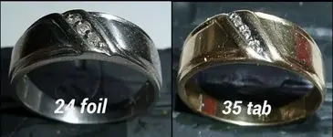

I found lots of gold and silver with mine in mostly trash infested sites, the pic of the gold below is of a lot of my gold with F2 VDI info I have found in the last few years.
About half of them were found with the F2 and most of those were with the sniper.
The two similar 10k gold channel wedding rings both with dimonds will give you an idea why I dig all solid signals from the low 20's on up no matter what.
The white gold one was bigger an hevier than the yellow gold version but came in lower because it was probably alloyed with nickel.
