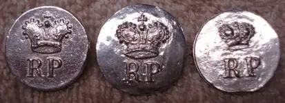

The photo on the left shows the common circa 1970's repro large crown flat RP button. In the center is a repro made from an impression of an original circa 1780 large crown domed RP button. The RP button on the right is the flat small crown variety, which is made from an original. There are many varieties of original RP buttons, some small crown, some large crown, differences in the thickness of lettering, shape and detail of crown, etc. I don't suggest that all flat RP buttons are repros, but the originals I've seen with large crowns are very slightly domed. I haven't handled more than six, so flat large crown RP buttons may be legit, I just haven't seen them. Next time I see Bill McMillan I'll have to ask for the history of how the 1970's RP button came to be as I think he played a part in this reproduction. I do know that just before the Bicentennial a lot of units were making buttons based on photos shown in the circa 1920 book by Calver & Bolton, "History Written with Pick and Shovel", however few knew that some photos were heavily touched up.

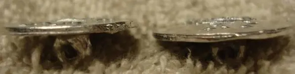

The photo on the right shows the very slight dome of the original button. It isn't much of a dome but is noticeable when side by side with a flat button.
BTW - a slightly domed British regimental button is very common, probably as many were slightly domed as were flat.
