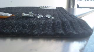

I went to the store today and got some metal and carpet.
Here are the pics of the start of my sluice box project.
Here is the carpet i got. The grooves may not be deep enough, but i will try it.

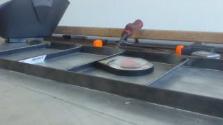

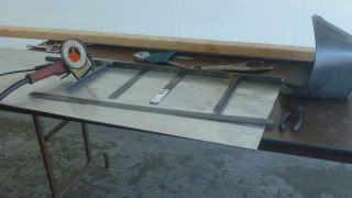

Then cut the sheet down and started making the riffles,

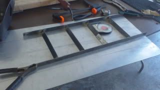

I set the riffle angle to about 45* and started tacking them in, about 6" apart
Then I ran out of welding wire for my mig, so that's all the fab i got done today.
I was going to use my friends sheet metal brake to bend the box, but he was not around today. maybe tomorrow.
I will add more pics as it comes together.
