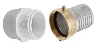

Are the threads on a male PVC fitting the same as the threads on a short shank female coupling like those you'd have on layflat hose? (see image)
I want to mate the 1½" short shank to a 1½" PVC fitting but I'm not sure if the threads are compatible.

They should be I've used simular fitting with no problem , generally always NPT .
The brass fitting on the lay-flat is a NST straight thread, the NPT pipe fitting is tapered.
They are both the same pitch (threads per inch) and same diameter.
They do work together but the joint will not be full strength because of the tapered pipe thread.

The plastic pipe fittings suck, they will eventually crack between the threads.
Metal fittings are worth their price.

Bob you can screw the NST brass hose fitting onto the PVC no problem as the seal is the rubber washer between them. I personally threw those connectors away because I was ALWAYS loosing that stupid rubber washer!
