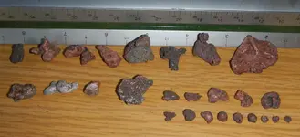

So I been locating some sizable nuggets of yet to be assayed material, Now clearly there is some copper involved and that is to be expected. However I had one of these acid tested in the 1990's at a pawn shop and all nitric acid did was polish it a little. Some of them do streak brown so they are mostly copper, but others streak yellow and that is always a good thing. Now my first question is, what to make of the silver stuff?
It is silver when it comes out of the ground even when the rest of the nugget is coated in oxides. Does that make it platinum? Chrome doesn't do that in nature does it? And silver would be black wouldn't it?

:icon_scratch: Looks like copper float or bullet shrapnel? Heat it with a lighter/torch momentarily.
Float copper for sure imo. As for the slide theory I think these were deposited in the river and washed down stream based on there river worn shape even being as soft as copper. If they were right from a lode source above the river eroded by a recent landslide they would look different and be more blocky. Just my opinion nice pieces though, copper is expensive we should probably be hunting copper nuggets:)

Well here is my collection of 'copper' nuggets. Some more copper than others it would seam. No #'s yet, but the collection is growing. Total weight 67.1 grams. Everything below this size goes in the heavies bucket for smelting. Shame I havn't found any solid gold nuggets this size, but I think I'll keep looking.

Well I do believe this to be native copper. But the way it's formed is odd to me. The mine reports for the area suggest I should be finding masses of gold equal in size to these metal slugs. To date I have not found any gold this large. The mine reports never mention large masses of native copper, just gold. Also the gold I have been recovering is just small crystaline masses and wires. I have melted some of this material before. It seperates into nuggets of dissimilar material that will not rejoin. Some of the blobs after melting are very yellow on one side. Others tend to form a hard dimply surface with a red hue. Both of these are good signs according to what I have read over the years.

The fire that you spoke of could bring temps capable of melting metal; especially copper and aluminum. It looks like the copper in your photos has been heated and left in contact with the ground while in a molted state. I didn't catch that last night as I didn't enlarge your images - trying to conserve data usage. :protest:
Your copper might be native, but also might not. If there were electric motors, phone/communications lines, anything of the sort, then a fire such as the 1910 fire could have melted pure copper.
