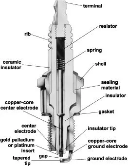

The valuable part of the plug is a small insert around the end of a copper core. Historically, this has been made of gold, platinum or palladium. Telling what is in each plug individually would be difficult.
