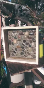

I put together a frame of very dry pine with an old scrap of quality plywood for the back and laid out the rocks. I screwed and glued the wooden parts and got a very tight and rigid box. Below is the box and the first layout of rocks to randomly chose from.
I first anchored the rocks with a stong epoxy, then mortared them in place with a sand based mortar, one side at a time. I let each side dry/cure before doing the next side. Time consuming, but much else to do while waiting.
After a couple on and off project days, I finished the setting of rocks, then put a clear sealer coat over the rocks and made a frame from some scrap molding. My wife painted the molding a color she liked (I wanted a driftwood frame) and I set it into the wall between studs.
A fun project, but now others in the family want one. Hmmmm!
