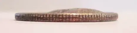

My Husband got this quarter in some change. It is a 1995D. There is a bulge on the heads side. The tails side has nothing peculiar- it is completely normal with no indention :icon_scratch:. Its dirty but the entire strike is present on both sides. Any ideas on this?….

it may be a fake, because they make coins with stamped blanks, from a rollof metal that goes through presses to make it the exact thickness they need
I have a dime but with smaller bulges, one on front one one back. The lettering is somewhat off but readable.When I dug it I thought it had been shot by a BB gun. :help:
Fire damage. :icon_thumright:

It's so easy to say "fire damage" without reading the entire post --- but if you folks had read it, the reverse side is apparently in tact.
MtnBluBrd, please post the reverse side of the coin so that there is no mistaking that the coin is otherwise intact except for the bump.
Lots of folks come to tnet just to be critical, and many times we need folks to be critical . . . but in this case I think if you can show them the reverse without any damage it might help them to understand that these things do happen WITHOUT a fire being involved. It is due to an imperfection in the metal struck.
Even with a defect in the metal, what would cause the surface to "lift" or bubble without heat?

A fault in the planchette will do this.
more often faults are noted as incomplete clads or peeling.
there could be an air bubble in the blank or planchette when the coin was struck.

In fact I had read the entire post before responding.
The U.S. quarter is comprised of a layer of pure copper sandwiched between two layers of a composition of nickel and copper. When these coins are exposed to extreme heat the copper core will start to melt and can cause bubbles to form. Copper melts around 700 degrees fahrenheit less than nickel, so the outer layers will stay intact far longer than the core. These bubbles will develop on the surface of the coin that has the least resistance, hence the bubble only appearing on the obverse of this coin. Personal experience with fire has backed up the science involved.
This coin, when viewing the available photos, appears to have had a good strike at the Mint. If the damage was due to an imperfection in the coin blank the image could not be struck on the coin as shown. Refer to the portrait of Washington and the motto that he faces.

Thanks everybody for mulling this over. I appreciate everyones input and am impressed at how quickly answers come. All I know is that it was an unusual quarter to get and, after reading responses, fire damage does make sense.
