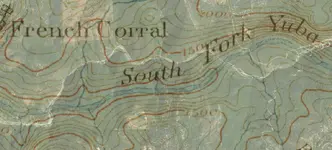

I found a great mapping web site for California folks that allows you to superimpose a map from as far back as 1885-1915 over a current map... you can see where the rivers used to flow years ago and this will refine where to look now. Take a look at this screen shot and see the old and new rivers together... Pretty cool stuff. I used and and walked right to a spot and got good Gold teh first pan! I love digital prospecting! Good luck with it.
the site is called CalTopo.
