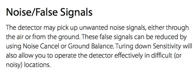

I was just wondering if anybody actually put in to practice or tested what the manual advises in two different pages
Screen Shot 2018-08-28 at 6.59.37 PM.webpScreen Shot 2018-08-28 at 6.53.04 PM.webp
