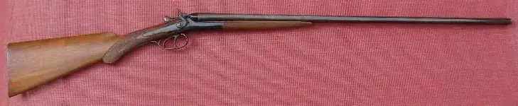

Back in the late 1800's they made some odd shotgun stuff. All brass shells at first. Odd gauges like 24 ga. and 14 ga. I have an old 1890's double barrel that is chambered for an obsolete caliber called ".44 shot". Slightly bigger than a .410, but not a .410. Gary

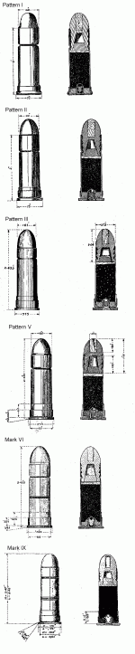

Wonder if it could be a .577 Snider round. I thought of that because my Pattern 1853 Enfield, made in 1863 and converted in Oct 1866, uses a similar shell, see below link. So it's a muzzle loader that has been factory converted to a breech loader, or a Snider-Enfield Mk II** conversion.
http://www.oldammo.com/january07.htm
To make modern shells for it we use brass (Or plastic) 24 gauge shotgun shells with about 1/2 inch trimmed from them.
The pictures of my rifle below, show what the rifle looks like after it was converted to a breech loader.
Thanks mike for the wonderful suggestion. What are the other measurements of the Snider cartridge. I don’t know what it is, but I do no it’s not modern and it’s not some zinc alloy metal. I do believe it is Brass, not copper.
Mike thanks again, I think I might have found a winner. I think it is an early 50-70-450 cartridge for a Model 1866 Springfield. Wiki said the .50-70 Government cartridge was modeled after the joslyn cartridge. Wiki provided no info on the Joslyn. This is the closest measurements I can find. I guess it is possible for it to be a Joslyn cartridge, but without knowing the measurements of that cartridge I can’t say. I also looked up a 58 cal Centerfire and it looks very similar in construction to that round, but I believe smaller but only slightly. I thank everyone for contributing their knowledge and time on this cartridge. https://en.m.wikipedia.org/wiki/.50-70_Government
