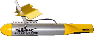

These are very good as an entry level machine...I seem to remember about $5000. (it is badged under a few names, so check around)
http://sharkmarine.com/Products/SurveyEquip/SideScan.html

My towfish weighs about 50 lbs. and sinks like a stone. I have not had any need for a (depressor) wing or other weighting system yet but they are common depending on what one is trying to do. I am glad I don't need one. However with a home-built system I can readily see why one could be needed because the towfish is just too light, as they are to my knowledge, not heavy enough.
I would really like to see images from home-builts. If anyone is inclined to post some that would be great.
I really would not be too confidant with that Edgtech, the large fins on the back will cause it to raise up under tow when the cable brings the nose up. The limited connection points at the top make it even more difficult to set up and fly level with confidence, let alone determine the depth. Edgetech has an option for a wing just because of that.
The diagram provided was an example, but in reality, it is a very simplistic example, as the combination of lift from towspeed, angle of the attachment varies with depth, simply due to cable weight and cable drag. This usually causes the lift, which is why the wings are so popular.
In reality, with the factors considered, it is usually a double catenary arc in the cable. That is why the cameras on the downrigger are great, you dont have to guess which way the nose is pointing and have a much better chance of flying the fish level.
