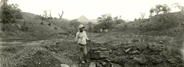

There are places that are impossible to get enough water to profitably pan with. The rocker box can reuse water better than any other classifying device.
This picture is from Greaterville - great gold NO water. Here's how they successfully mined under tough conditions with limited and expensive water.
Those miners that worked Greaterville for the first 20 years had to pay a silver dollar for each 5 gallons brought in from miles away by burro. A silver dollar then was worth about 1/10 ounce (3 grams) of mined gold. 5 gallons a day cost 2/3 ounce of mined gold a week.
For all of you who think you are smarter than the miners who successfully worked Greaterville for years - drywashers aren't effective there because of the clay content.
Most of the best placer gold deposits in the west are still there because today's miners believe every deposit can be mined with a sluice or a drywasher. It just ain't so.
More than 60% of the gold bearing Tertiary gravel deposits in California lie untouched because:
  • They are too far away from running water to sluice.
  • The pay material is too damp or too concreted to process with a drywasher.
  • It's too steep and remote to effectively set up a recirculating sluice.
Look at the picture above again and ask yourself how else you are going to process those rich deposits on the hill above your played out river with only 5 gallons of water a day?
Light weight, no batteries or gas engines, minimal water use, small footprint - rocker box. I'm thinking those old time miners knew a thing or two about how to mine difficult deposits. :thumbsup:
