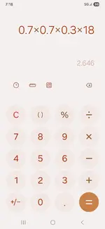

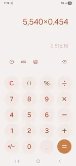

So this container is more or less square right? 28 inches by 28 inches? That's 71 cm × 71 cm.
I mean 71 by 71 by 71 cm....
I am gonna calculate the cubic m of space and then see how much it should have been filled with Au in order to contain 2500 kg gold. But how did they carry it?? Did they mention hooks or some kind of metal handles?
I calculated 0.7 m × 0.7 m × 0.3 m × 18 tons ( if it is quite high grade gold purity )
It came to just 100 and some kg more than what 5540 lbs would have been in kg.
But.I allow for empty space in between the gold money and also between the walla of the container and the contents. So it must have been full not to 30 cm of its height but maybe to about 35 or 40 cm of its height. So around 57- 60 % full. Which sounds logical.

Oh you metrics....
Yes assumed a cube. It looks like the top and bottom of the box is 4" thick, so I assumed the sides were the same. It leaves a core of 20" x 20" x 20". How do those numbers work out (metrically speaking)?

Well, I put in 0.51 m× 0.51 m × 0.51 m × 18 tonnes for very high purity gold. Probably close to 21.6 Karats.
= total = 2390 kg roughly.
So the entire space of this cube will not be enough to fit the 2515 kg content. To the ceiling full, not enough space.
Just by little..
Then multiplied 0.51 × 0.51 × 0.51 × lesser purity gold > lets say 15 tones = 1.99 tones or 1990 kg. Even more deficient space this box offers.
For this kind of gold. I didn't subtract total weight accommodated for empty gaps of space this time.
I think not very logical for them to have been filled it to the top.
