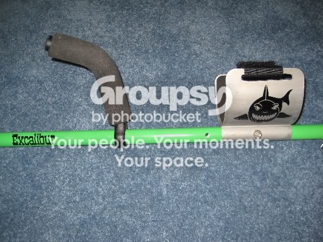

Would either of you have a picture of what your set up looks like?

here it is
U get the tube at Aircraftspruce.com get 6061t6 7/8 OD .745 ID 4 feet @ $3.20 per foot #03 36450.Your lower shaft will measure .744 which makes for a very nice fit requiring no lock nuts. Go to a bike shop and get the long bar ends with the bend $19.95 a pair and pick up a package of foam grip covers (4) for $9.95. Use your arm cuff off your old S rod and the pods for templates to drill the 1/4 holes. Use 1 3/4 x 1/2 SS bolts if U can find them otherwise get 2 inch and grind them down. Use SS wing nuts on the pods and a SS/nylon lock nut on the cuff. I usually remove about 6 inches from the 4 ft length so I can put much more lower up in the tube for more strength

my excal hasn't arrived yet but I got my tubing and even have the paint to match thanks to Pete.....
