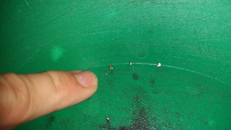

P.S.S. Whats an update without the results, right!?
Top tray with the 1/8in punch plate over vortex
Bottom Tray with Gold Hog Mats
Soooo.. It finds gold.. Now I just how to work out the kinks and dial in the efficiency.
