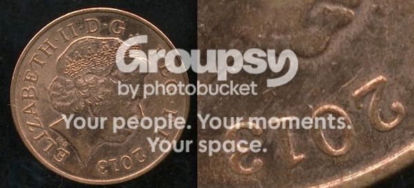

Close-up picture of coin taken with a scanner:
Thank you John.. Exactly the information I was seeking!
I need to scan buttons, retaining depth of field. The newer scanners lack this ability just as your blog post describes. Finally I have the optical term feature > CCD Charged Coupled Device, I needed to zero in on to avoid another costly mistake. I thought these were no longer being manufactured at all, so I was in a state of pending - what to do - trying to avoid more cash outlay for a tripod that would tilt face down, which has lighting issues too. A scan is so ridiculously much easier.
