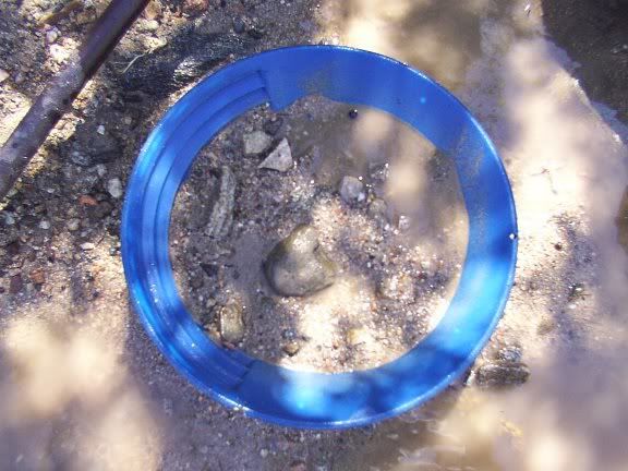

The amount of material a 3 inch hand sucker will move
deserdog
May 17, 2013
508
444
I did a test to see how much material a 3 inch would move. This is material right from the creek, after loosening it up with my digging bar. Each pan is one suction stroke. First picture is all of thematerial in a 14 inch gold pan, then the oversize in a 1/2" classifier.
