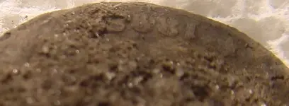

OK the date is three quarters of the way there and you can all guess what the last # is . :D I also did these in close ups and zoom to really show the condition of the metal that is left. I have some other thoughts on this but I need to hit the sack. I will post more on these pics tommorrow. HH

Yup Floater! I think you found a 1831 chucky cheese token!!!!
That should parley into about 400 Pizzas' Just kidding.....Great work!!!

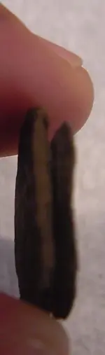

As you know the coin started to de-laminate and flake.In trying to get the last bit of surface exposed the metal became to thin on certain areas that we already had a good view of.
I am so happy that I did take pictures as the work progressed because we have lost some of the definition of the coin. I am now trying some chemical cleaning to bring up what is left and will post those pictures tonight. Here ya go.

More Picture's. Notice the last one though. At least we are able to see the bust now.No silver lining I know but we are trying.
