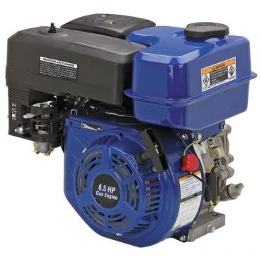

Next is the engine to drive the pump.
GreyHound 6.5hp weight, 40lbs retail: $149.00 (Harbor Frieght) $85.00 (Ebay)
This engine has more power than what is needed to run the pump, but not too much difference in price compared to the smaller engine listed below.
GreyHound 2.5hp retail: $119.00 (Harbor Frieght) Advantage with this engine is lighter weight

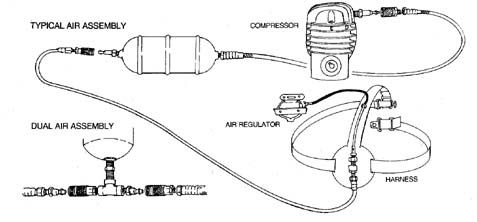

How to set up your hose:
Run a 6 foot lead hose (male thread on one end, female thread on the other) Male end connects to the pump,
at the other end, you attach a female coupling,
From the female coupling, you thread on a female quick-connect coupling (one end is male threaded)
At both ends of the air reserve tank, you will screw in the male quick-connects that look
like this:

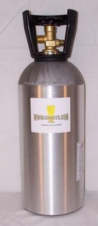

(cheaper alternative version of air reserve tank, 1 or 2 person. Food grade Co2 tank from any keg supply company)
Retail: $95
Then you attach your main air line (whichever APPRORIATE length you choose) to the other end of the air reserve bottle in the same fashion as your previous connection.
Next, you attach a female threaded coupling to the hose that exactly matches the male threaded coupling that is on your 2nd Stage Adjustable Dive Regulator.
Here is Keene's illustration of the entire system:

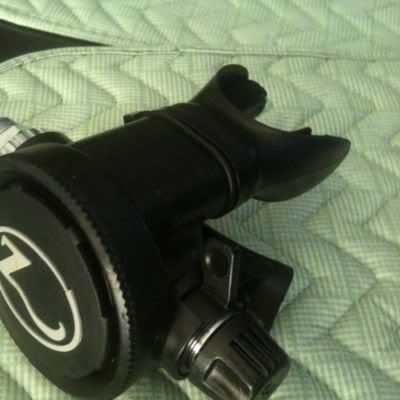

Keene recommends using a harness for your regulator, I believe this is wrong and potentially dangerous, they are far to easy to get snagged onto things underwater, and they are a pain in the neck to put on and take off (I had used one for a year, I HATED IT). The safest way to attach the air line to you is to velcro-strap it to your upper arm.
Regulators can be found new and for good prices on Ebay and other sources online, but can also be had at real rock-bottom prices from scuba dive shops looking to sell off and replace thier older rentals. I buy mine this way, the shops are always happy to also throw in fresh new valves and springs before sending out the door, and they always work like new. You can easly have a $300 regulator for a price of $30-$50 bucks if you shop around.

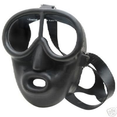

If you want to really be sporting stylish and be comfortable, as well as have the ability to talk and sing to yourself while under water, go with a full face mask. All you do is cut the zip-tie that is holding on your regulator mouth piece, remove the mouth piece and plug it into the mouth of the mask and zip-tie it snug on the inside. Voila! SIMPLE, and you will absolutely love it and you will never experience jaw fatigue ever again.
Cressi Full Face Mask Retail: $75-$100
