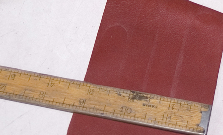

I'm not sure about this ... but maybe something to it. BigCy your research led me to this- could it be used for measuring the fingers of long gloves?

It may be called "French Inches" I found this French Gunners caliper. I dont think your is that old though but interesting. TESSERACT -- Antique Scientific Instruments -- Demonstration, Experimentation & Calculation
RARE FRENCH GUNNER'S CALIPERS, c. 1800, signed "Baradelle a Paris," 7-1/2" (19 cm) long (closed), of brass with finely inset steel tips. One side is engraved with a linear scale of (French) inches and twelfths; diagonal lines for "Canon en Bronce:" (using the Spanish spelling of "bronze"!) and calibrated 1, 2, 3, 4, 6, 8, 12, 16, 18, 24, and 36, for direct readout when placing the calipers on the inside diameter of the cannon bore; a circular scale around the hinge, similarly calibrated and labeled "Boulet," for direct readout when placing the calipers on the outside diameter of a cannon ball. The other side has an edge scale of decimeters, centimeters, and millimeters, and diagonal lines for "Canon en Fer." Condition is very fine throughout.
Good possibility. I see there is much information out there on "French Inch" but its a lot to read. The French Inch may be about 1/16 inch longer than the English Inch.
"A French inch was 2.71 centimeters while an Imperial inch is 2.54 ..."

Maybe we could see a picture of it inside a glove finger?
