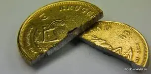

Tungsten is almost as heavy. Some have cast tungsten into things and gold plated them to sell as solid gold. I don't know what color it pans out as.
Tungsten metal is silvery gray. Of course it can be alloyed to other colors. It's so close to gold in density that the Chinese (and maybe other) have made counterfeit gold items with it.ImageUploadedByTreasureNet.com1451947567.069662.webp
