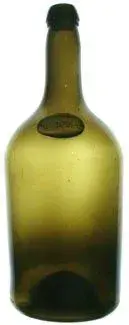

Here's another wine bottle, a magnum with an applied seal. The seal reads MADERA for Madeira, a fortified wine named after the Portuguese island of the same name. The bottle is English (or American) from the mid-1800s.
madera.webpmaderab.webpmaderabb.webp​

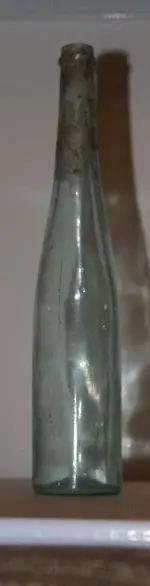

This is a cool little champagne. Found in the railroad dump. It's a mini, 9" tall. Interesting base design.
Another hock wine form. I'll bet it's a half-bottle. What does the embossing on the base say? I cannot make it out.
Harry, it looks like a smaller fancy 'R' over a larger fancy 'M'. Mold damage makes the right hand leg of the 'R' appear to be a bit weird looking. It could be a P over M, outside chance.
Well, that is a lead to identifying the vintner or bottler.
It's more than possible that it is an American winery -- colorless glass is not typical for Alsatian wines; plus, there's no kick-up.
