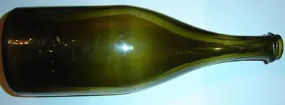

Here's a nice one I have.
Isn't that a great neck and lip-finish!! Full of character! That's a slender string around the llip to have survived all this time. Your bottle looks to be in excellent condition. :icon_salut:
I am fascinated with these early wine bottles -- in this case a champagne bottle, I think. French wines, including champagne, were exported in such numbers that they can be found almost anywhere (if you're looking and you're lucky). I've actually recovered some of these champagne bottles here in Florida. Here's an image of two of 'em. I think your champagne bottle may be a little older than these two, but it's difficult to assign any firm dates to bottles that changed little for decades.
Show us some more!
