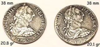

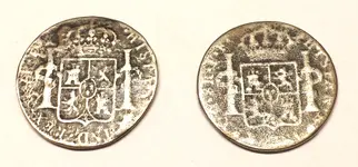

Would you guys take a peek at these? When bought had El Cazador note in the flip. an antique store owner who claims to know coins said fake, but still wanted to buy.
I think the weight should be close to 27 -28 grams.
And the pitting looks like sand cast because of the porosity/pitting on the surface.
Magnesium is used because of the similar look to silver but the weight will be way off.
