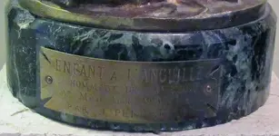

I have another bronze that I cannot find another example of anywhere except the original here- https://musees-occitanie.fr/musees/...s/jean-jules-pendaries/l-enfant-a-l-anguille/ ,Museum of Fine Art of Gaillac in France. It's pretty tall and weighs like 28 pounds. The original is titled "L'enfant à l'anguille" by Jean Jules Pendariès. This one below is not mine. Mine has a golden color to it. I'll get a pic up in a bit.
EDIT- Here is mine. The tag translates to "The child with eel a tribute to my friend Jean Jules Pendariès" or something to that effect. Notice the eel is at a different position in the hand. However, it is not signed anywhere. that I can find.
