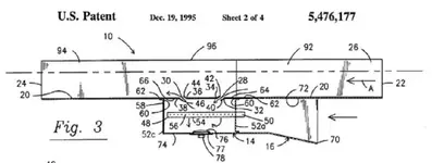

Regarding the trap design ....
After all the discussion so far I currently think to make the trap straight and about 8" wide and 12" long. I think about a tray design with adjustable chambers to have the chance to play with single trap vs double trap vs triple trap (even if I dont expect to much gain from last). But I expect that running a 6"/4"/2" combination vs a 3"/3"/3" vs 2"/4"6" vs 6"/6" and 8"/4" vs 4"/8" vs 12" combination might bring some interesting results. (I wished one of you guys would do this on rich ground... just for the science)
For the sake of science I'd double run some 20 gal dirt into a safety bucket (to make sure there is no gold anymore) than add some known weight of gold to these tailings and rerun all. Than measure the traps seperate. That should give a good point what settles where in what percentage. Afterwards mix all together for the next setup and rerun. Afaik this has not been done before but should add a lot to our knowledge.
I know, that some might say this effort is not worth the gain. But imagine, if one makes "only" 1oz gold out of a sluice in its lifetime and gains only 1% more (for the same effort in shoveling), how would this compare to a 2,-- $ price tag for a additional divider in the right place? Now what would be about a kg then? We'll never collect all but 1% can be real money even on the small, but in any case on the larger scale. And who would buy a +200$ sluice hoping for "only" 1oz in its lifetime?
For the tubes I think 4 * 1" should give more than average agitation in the fluid beds.
Any comments or suggestions?

The way the trap and tube holes are designed is to keep the trap fluid with out scouring. Holes on the side or in a spiral will actually prevent fluidization....
You guys can argue and tinker all you want... I just want to point out that I know the inventor( re-designer if you will owner of the patent) I know the bazooka inside and out literally.... I would be careful of making too many " improvements"

Fig. From original patent ..........
*NOTE that the hole position is horizontal and there is no uphill grizzly.
(Double click diagram to enlarge)

That sounds like some improvements went wrong, or some built without understanding the concept. Should make you lucky ;-)
