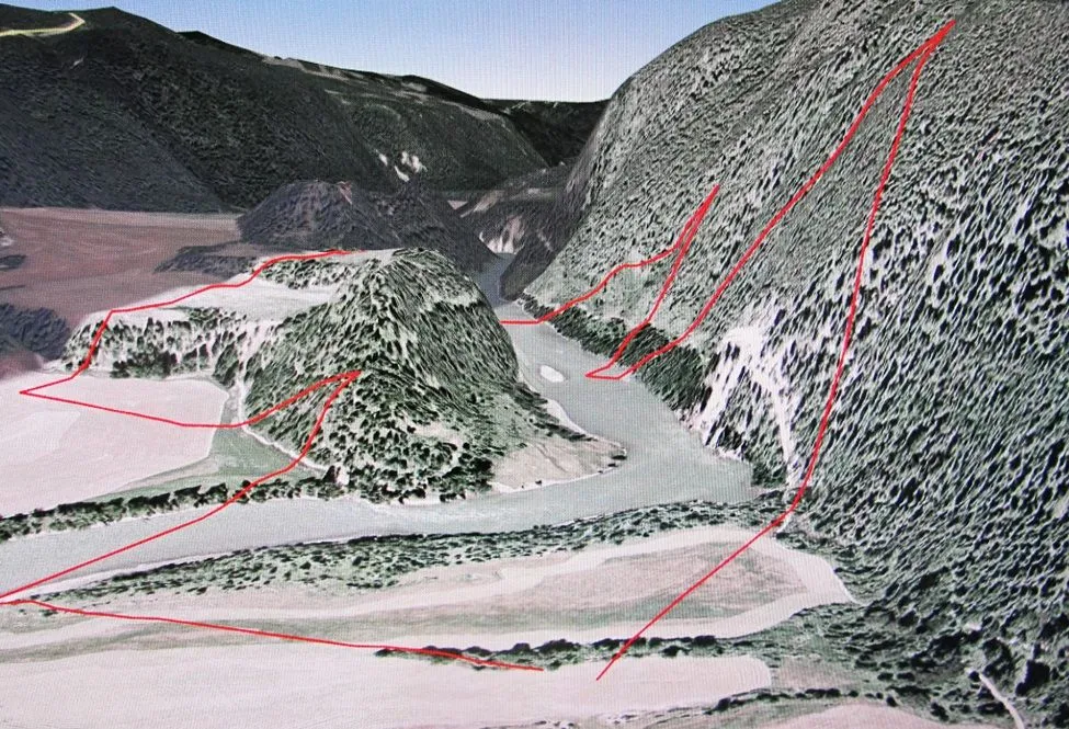

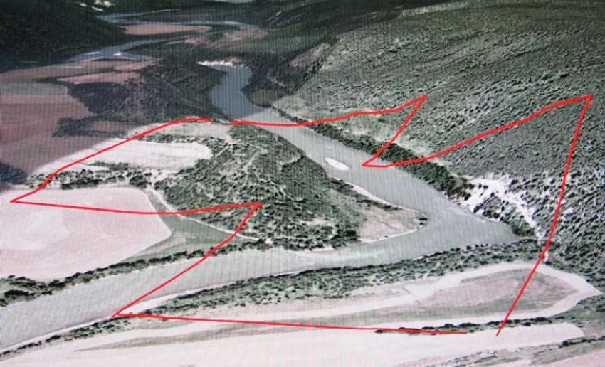

All great stories..enjoyed the read. Picked up a new claim that looks like it has potential. The following view is from Google earth elevation exaggeration. The red lines show the area of the claim. Lower left is an inside corner flowing directly to another inside corner on the bar. From center of bar to the base of the hill is 280 meters and from center of bar to the island is 520 meters. Lots of area to work plus the hill side. This view could have been how this was long time ago. Considering over time that the hill has worn down but still a good size where as some of the surrounding area is well worn down. From what I could find it appears this area was not worked over all that much......Second picture is a normal view of what the ground is today...I'm looking forward to exploring this area this year especially the hill side and potential finds....
From the first picture view it appears this may have been an old channel under water...
What are your thoughts of workable bedrock in that hill side that seems to have stood the test of time.? All opinions welcome..
View attachment 1257063......View attachment 1257067
Is there any visible bedrock? It's hard to tell from your picture, but as the hillside by the channel seems to have remained quite similar, there must be something making the river right-angle like that.
Can you use a dredge to sample along the hillside to see where of if there's any bedrock to be hit? If not, a good sampling program along the side will tell you what Mother Nature's been dropping along there over the years.
As for your inside bend, that looks quite promising if there's good gold in the area as nature can't construct a much better low-pressure system in the water flow than the one in your pictures! The first jut (starting from the left, if the stream is flowing left to right) will drop some gold in a suction eddy during high flow, and the big bend that follows will create a super-suction eddy where heavies will have to drop out during high flows, with fines dropping during regular flow.
So, hopefully your bend will produce some nice fine gold on a regular basis, with the coarser stuff dropping during higher flows. There's a shot at hitting a very nice pay streak if it hasn't been worked that much, but I know nothing of the gold recovery history for your claim. Additionally, you may have some coarse gold slam into that right-angle of the side-wall and spin out gold as it loses velocity there as well.
It should prove to be a very interesting sampling session for you. Moreover, be sure to let us know how it works out in the 2016 season.
All the best,
Lanny
