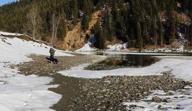

Is there any visible bedrock? It's hard to tell from your picture, but as the hillside by the channel seems to have remained quite similar, there must be something making the river right-angle like that.
Can you use a dredge to sample along the hillside to see where of if there's any bedrock to be hit? If not, a good sampling program along the side will tell you what Mother Nature's been dropping along there over the years.
As for your inside bend, that looks quite promising if there's good gold in the area as nature can't construct a much better low-pressure system in the water flow than the one in your pictures! The first jut (starting from the left, if the stream is flowing left to right) will drop some gold in a suction eddy during high flow, and the big bend that follows will create a super-suction eddy where heavies will have to drop out during high flows, with fines dropping during regular flow.
So, hopefully your bend will produce some nice fine gold on a regular basis, with the coarser stuff dropping during higher flows. There's a shot at hitting a very nice pay streak if it hasn't been worked that much, but I know nothing of the gold recovery history for your claim. Additionally, you may have some coarse gold slam into that right-angle of the side-wall and spin out gold as it loses velocity there as well.
It should prove to be a very interesting sampling session for you. Moreover, be sure to let us know how it works out in the 2016 season.

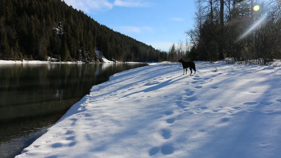

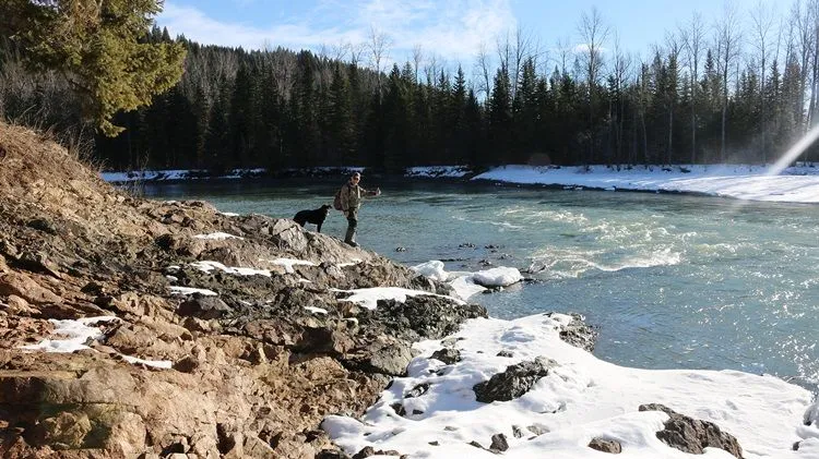

Took advantage of the beautiful weather here and hiked into the claim and it was worth every second of the hike in. Yes Lanny there is exposed bedrock.( this explains the hard right angle ) The point is all bedrock and extends a long way into the river (should be a good drop zone) The hill side also has exposed bedrock and possible more when the snow is gone. The high water mark shows and where it meets the upper bench it looks like it is exposing and eroding each year. We did some pan sampling and got some fine river flood gold flakes. The real surprise was the amount of black sand. When near the end of panning down to the very last fines at the very least half the pan was black sand. Looks like many years of good detecting here..........
/QUOTE]
Well, it's nice to know you've got bedrock, and it's great to know you found color, plus I wish you well with your detecting. I admire your tenacity to get out to inspect your claim on a snowy day. But, I've gone out chasing the gold in the snow myself, so I understand the drive to do so, especially this time of year.
All the best,
Lanny

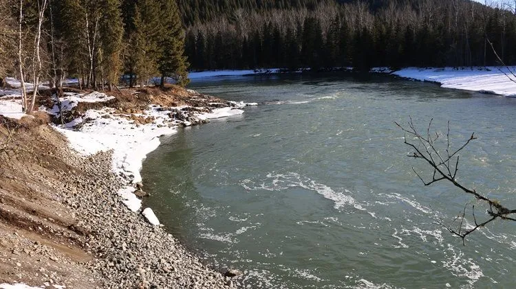

View attachment 1266875......View attachment 1266879......View attachment 1266880
Hi Cariboo5... what a lovely, scenic claim site you have there. I hope that you have a great summer finding gold... regardless how much or what tools are employed... it's all good. Thankyou for sharing those marvelous photos and making a wintertime effort to visit the claim to do so. Please keep us posted about your sampling activities, and of course any interesting rocks that produce a "beep" on your detector. Be safe out there Dave, and good luck. :)
Jim.
Jim.
Thanks Jim, I'm sure looking forward to this spring & summer here. With the diversity and size of this claim we plan to employ different methods such as: sampling in a grid pattern from the bar up to the hillside, metal detecting, sniping and working the bedrock, setting up the high banker as a wash plant and hauling hand dug pay dirt to it and gravity suction dredging.
The area does have magnetite so there is a chance of a "hot" beep. Would be nice to come across the lodestone variety which would be a first for me. If lady luck gives us a hot rock I will let you know.
Thanks again Jim & have a good one......
The attached picture is the top of the claim which gives us more ground to cover.
