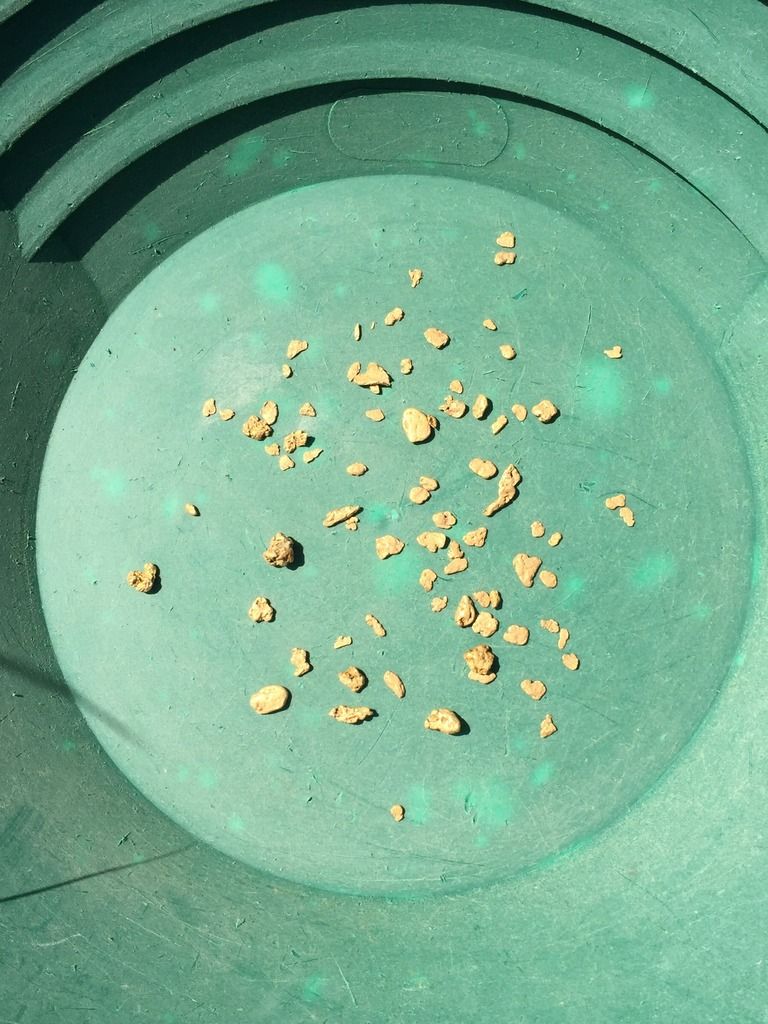

With the gold collected in the bottle, I went to work on the flat. The Gold Bug Pro got immediate hits, but there was metal (the wrong kind) everywhere! So, I pulled out the wand magnet and went to work. Hedgehog time! And again, more hedgehog decoration on the end of the magnet. After that, I went back to detecting. I'd like to say that I didn't dig any trash, but the clay clinging to the bedrock is a master at holding tiny bits of steel away from the draw of the magnet.
http://
I stared scanning again and got a hit right away that popped up in the 40 range! It was a great little nugget of just over two grams. I worked the bedrock until it went silent and by the time I was done, I had a nice collection of gold in the bottle, flakes, pickers, and nuggets. The biggest was only five grams, but the total weight back at camp was almost 16.5 grams! What a day, and the gold ranged from pancake flat to real character pieces. Man, did that fire me up!!
http://
That experience led me to a very similar location a couple of days later that exceeded this story's take, and once again, I had to make my way through a water hazard to get there.

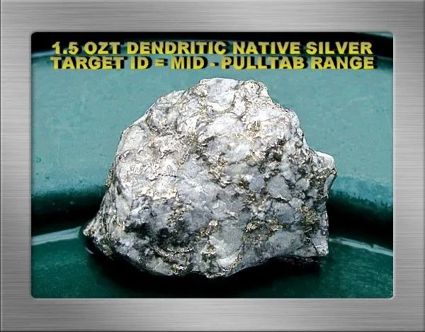

PS: Been cleaning and photographing some small silver finds from last autumn, let's attach one to spice up this post.
1.5 OZT DENDRITIC SILVER SF17PANYYGN.webp​
That's an incredibly beautiful find Jim!
