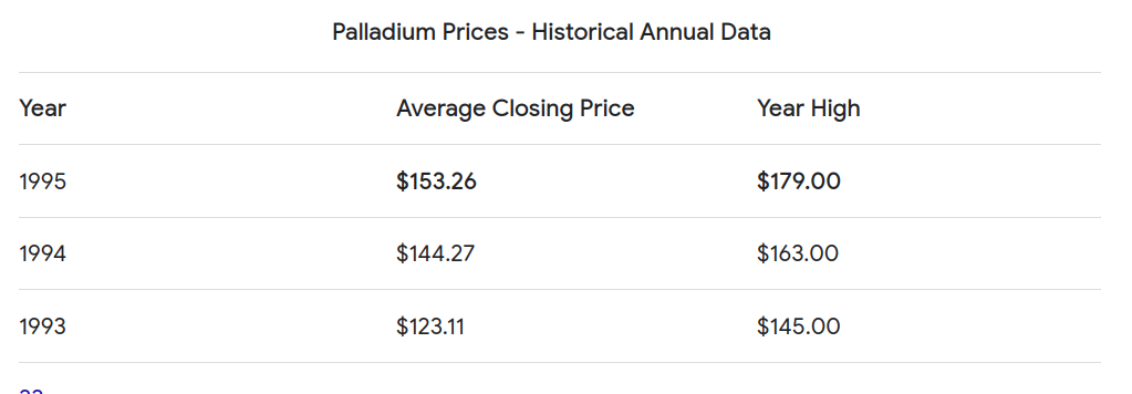

I suspect the reason green boards are worth more money is the small IC's contain a lot of palladium. Back in the day when these chips were manufactured, palladium was worth much less than platinum or gold.
July 2023 / 23, palladium spot, Palladium $1262.00
