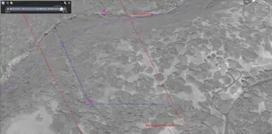

So I live on the somerset/placerville boarder, my property backs up to the cosumnes river, about 2 miles from E16...
(A SPOT on Image)
So I just went down there for the past 2 weekends with my bazooka gold trap, and ran about 10 buckets from the sand bar and from random holes and pockets in the river, I was able to dig down about 3 feet, with total depth wearing my waders was about 5 feet... Not a single color, no flour nothing... So that was all within the cosumnes river.
I would think there is gold around here, because reading about Bucks Bar Road history there was mining camps posted up all within a mile of my land.....
(B Spot on Image)
Anyhow the 45 min hike down I always noticed like steep old river beds or something as it is deep dry trail....
My understanding is ancient rivers run North/South and modern rivers East/West. This old river clearing is running N to S , So not sure if stumbled on something there or not.
So anyhow I decided to check out Google Earth this evening and noticed you can clearly see what looks to be a ancient river, The photos below show (RED) my property lines, (BLUE) what looks to me to being a ancient river...
What I was thinking to do is try digging deep where the water would of came down and kinda to the the sharp right turn, this is the best I can tell where the flow of the water went...( B SPOT IMAGE)
The trench looks to be about 10 feet wide currently and has large trees growing in the middle of some of the area so looks to be very old...
Anyhow care to comment? any advice as I am new to all this prospecting, But I am very addicted now and just bought the Gold Bug 2 detector....
Is it worth it? do you think I would have to dig too deep to see anything???
Thanks a bunch.

The land is private with my home on it, but yes I know what you mean as far as if I do find some I need to claim the mineral rights as well.
1st of all, private property and mineral rights is a tricky subject that I won't go into. The fact is somebody else may still have mineral rights to that property, other than the land owner so research is in order.
Now down to the possibility of an ancient river there. Not that it isn't possible but I doubt it for a couple reasons. Most ancient rivers are buried with no noticeable surface indications. They tend to show up out of seemingly nowhere like road cuts or where a current day river cuts through the old channel. My other thought is looking at your map it seems to be a terribly straight line. Straight lines are not that common in nature. I believe what you might have there is either an old cut done by miners long ago, or more likely a fault line. I would check USGS maps that show faults in your area and you may find the answer to this question. It could just be a fold from the mountain building process as well. No matter what it is, taking some samples certainly couldn't hurt. You never know what you might find until you take samples.
Certainly there is gold in the area. Don't get frustrated. When you are digging along the river, sand bars aren't the best place to look. Better to find bedrock and drop zones. Gravel bars are certainly better than sand bars. Do some more research on how gold acts in a river system. Areas along inside bends and places where the river goes from narrow to wide or where the gradient levels out and the water slows are all good places to look. Sample areas as opposed to digging willy nilly. In time you will discover gold, given you work smart and keep trying. Sample, sample, sample, and sample some more. Dennis
Simply go to the new Pioneer mining store in Auburn and purchase Franks colorized map showing the exact locations of the old ancient river from north to south and MUCH will be revealed. He blew up and colorized a state map to show much more detail. Consumes is spotty for sure,quite a bit of slick bedrock above hi way 49 that doesn't catch gold worth a darn. Associate lived above 5 miles or so from 49 and he/we mined/detected and got fines yuck-John
Your in a good spot promise your just gonna have to poke around a bit until the gold starts to show its local characteristics. you have tertiary river channels in the area but, they are out towards the national forest more. Keep in mind there is a difference between a bench deposit like you may see in your picture and an anchient river channel. There is a ton of decomposed granite in the Consumnes so that sand bar is most likely gravel with sand on top. There are good spots between Bucks Bar and 49. Access is a really good thing to have.
Make sure you have the mineral rights and then if you can get a tractor down, do some sampling at the river. I would run a test at the east and west boundaries to start.
