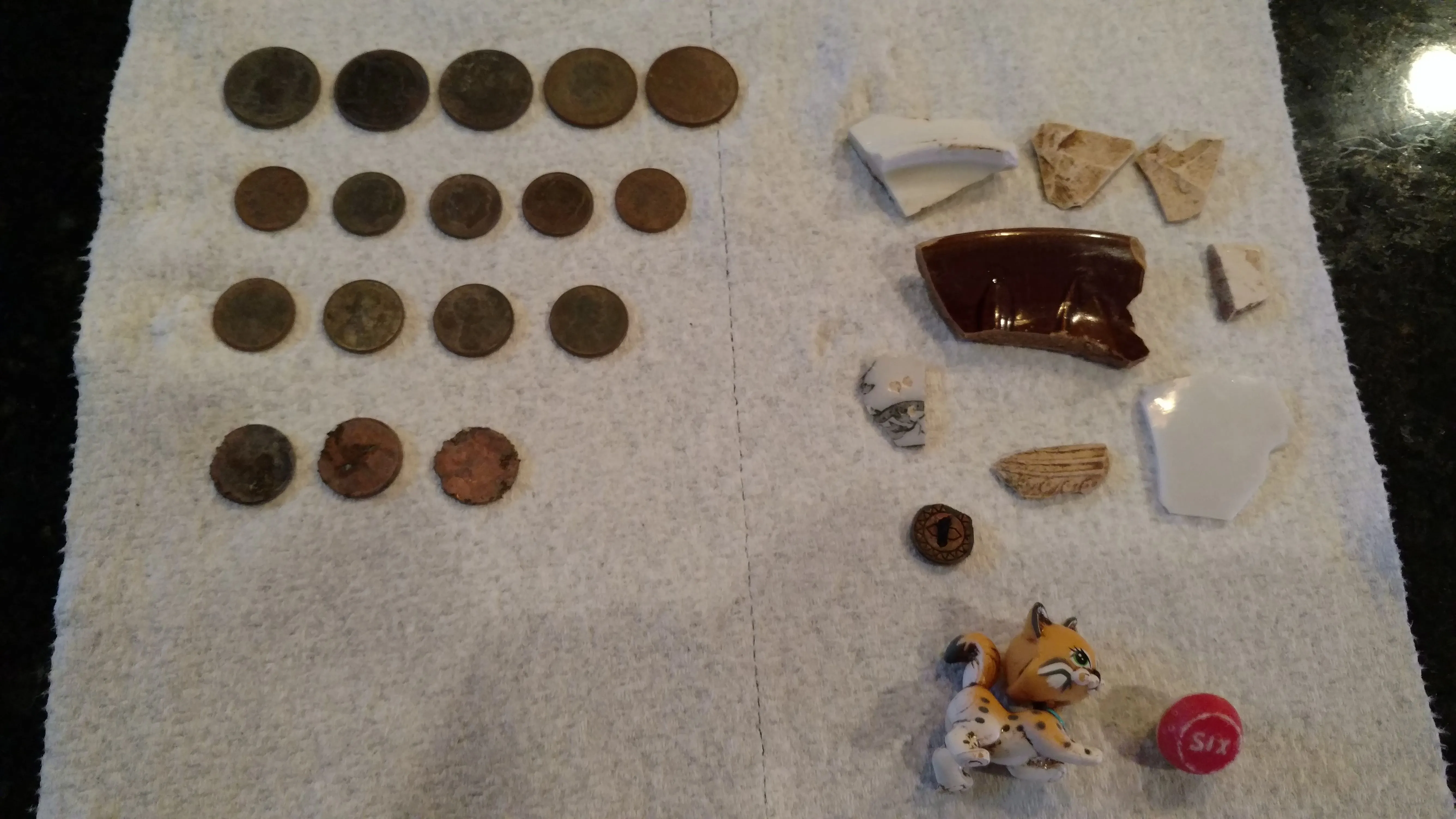

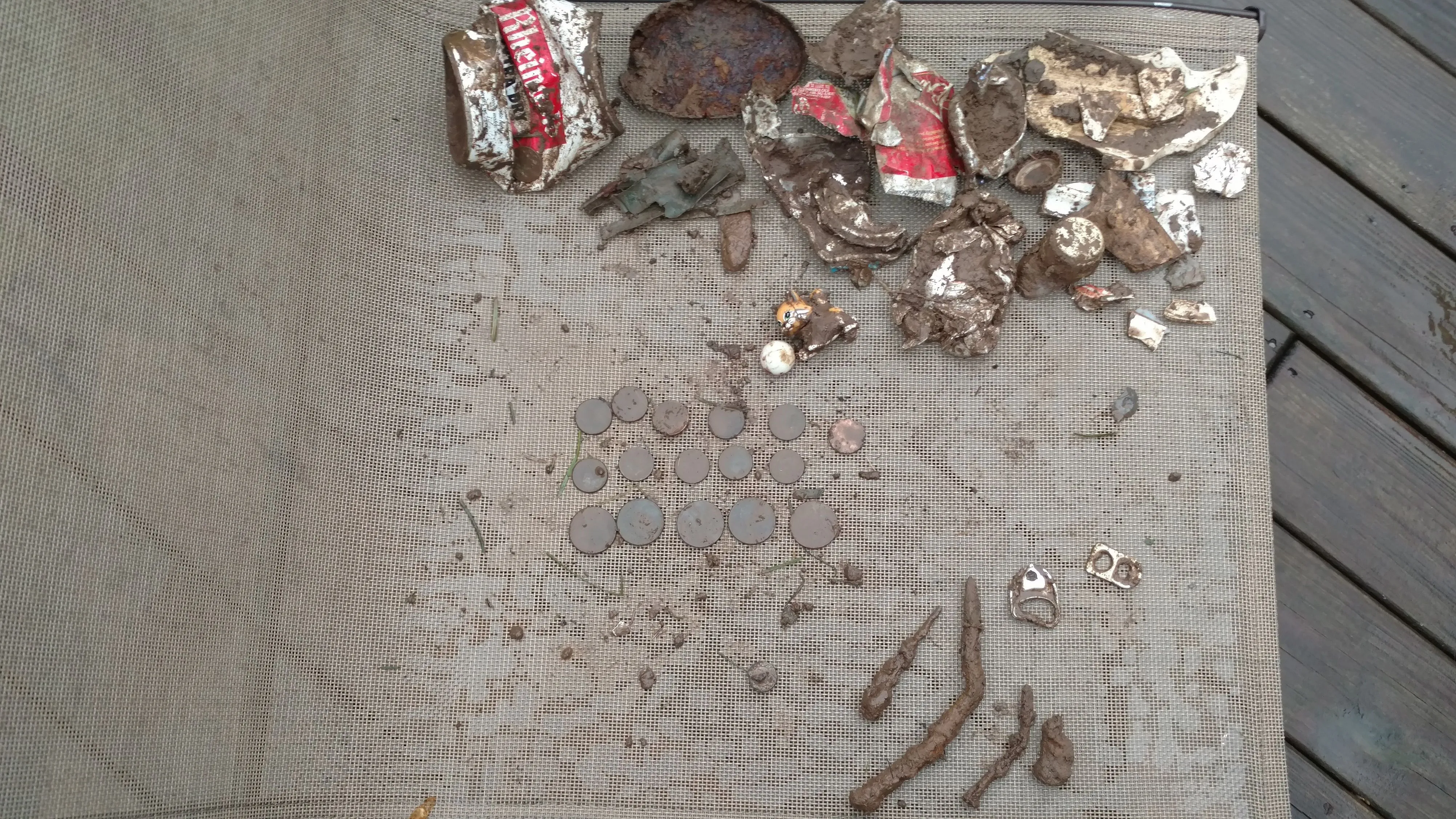

Well for the life of me, I cannot get a photo to upload tonight. I will try again in the morning. I have one of all the finds and the can slaw and one of the finds cleaned up some.
Ok got them.

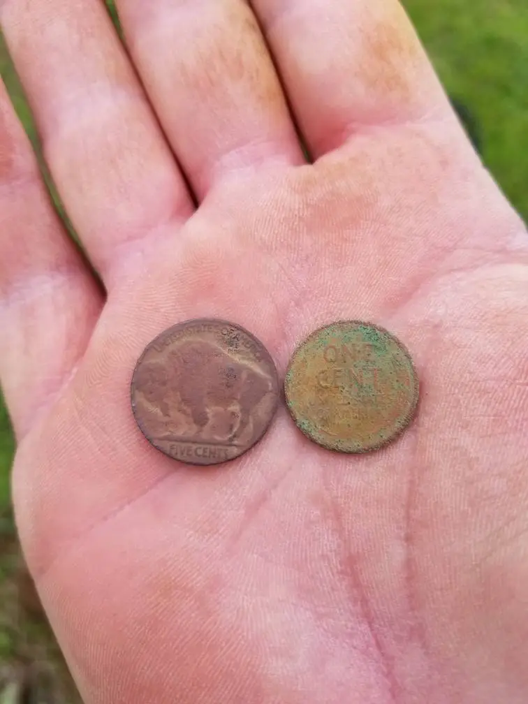

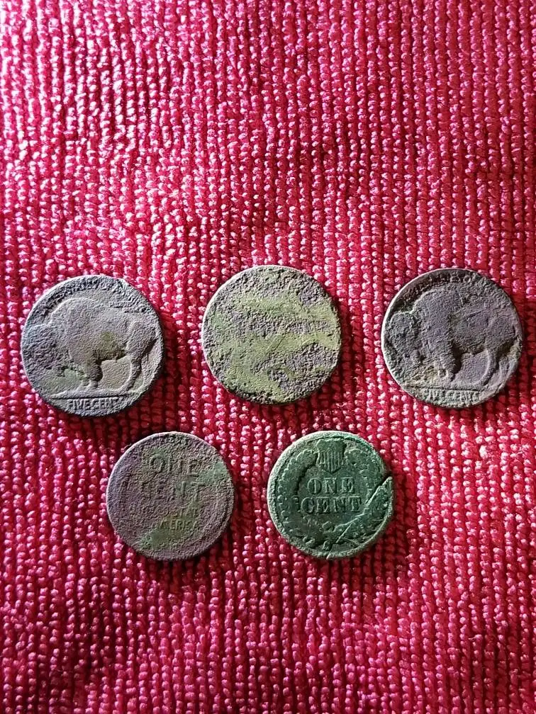

Nickels seem to be the equinox strongest suit for me, I have found some buffaloes and a V nickel in just two short hunts in areas that I had previously hunted numerous times. The VDI hits 11-13 dang good chance of a nickel. VDI jumps from 12, 13 to 14 or 15 and seems more jumpy in general = trash...I believe in time this machine will prove to be the best nickel hound ever made...

I glad to hear that the 800 is strong on nickels! I look forward to passing the coil over a few. Thanks for the info.
