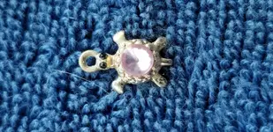

For me, the Equinox has been especially effective on mid-conductors (nickels and gold) at depth in wet sand and surf. I have even pulled some deep wheats off my local park beach at depth, one was mixed in with a steel wire, but the signal just said dig me. If the VDI is stable (i.e., solid or bouncing no more than 2 to 5 points) then I dig it and sometimes make the call to dig on unstable signals if I suspect multiple targets in the hole as was the case with the wheatie above and with a coin and fish hook I pulled out of the hole yesterday. Drawbacks are it likes really small targets and if they fall outside the very low obvious VDI foil range (with accompanying "hollow" sounding audio), can be really annoying. Recovered some very small fishing weights, button pieces, and other small solid but small non-ferrous metallic items.
