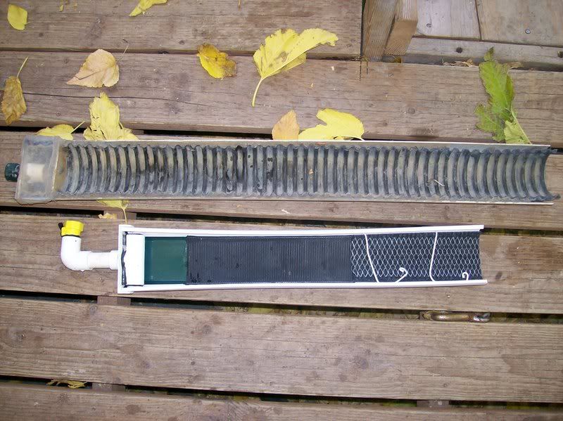

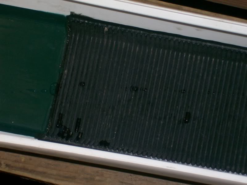

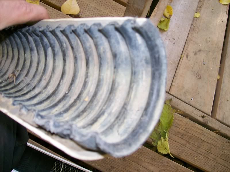

Here is a very hi-tech devise for your consideration. It is called a piece of ribbed 3" septic pipe or tube (poop tube) Here are some pics, you do not need to be this elaborate either, take a small length at least 24" in length, put on a slight incline ( you will have to judge this, trial and error ) and add water from a garden hose and use a catch bucket so you may re-run the material again if need.
You will find that this little apperatus is very efficent and effective and is very very cheap and can contend with some big dollar contraptions.( Effectivness will depend on tunning, More incline , less water, less incline, more water.you will have to find the balance for your material.)
Just remember who tipped you off...This can also be used in the field if you classify your material to at least 1/8th" and use a recirc system.
In gold mining, it is not the cost of your equipment, it is what works and commonsense(knowledge of specific gravity). I know this type of recovery will work for you. If you still have a problem after trying this, do not hesitate to contact me for alternatives ;)

HOW TO BUILD A HENRY HENRY "POOP" TUBE
Heres How You Do It
Go to your local Home Depot or Lowes
Purchase these items.
· 1, 1x3"x 8' pine board.
· 1, 8' length or 4"dia corrugated plastice flexible drain pipe "not perforated".
· 1, small pack of flat head wood screws #10 in size.
Now go to Walmart into the Sporting goods dept and purchase a 12vlt boat bilge pump 750 model.
You now have all of the ingredients to build your Henry "Poop" Tube.
NOW FOR THE ASSEMBLY...
· Cut the 8' 1x3" pine board in half into 2, 4' peices. Use one peice save the other.
· Cut the 8' length of corrugated drain pipe into 2, 4' peices. Save one use the other.
· Now take the 4' of drain pipe you are using and split in to 2 halves, by splitting it length wise.
· Take one of the halves of the drain pipe and screw it onto the 1x3"x4' pine board.
· Put the screws into the bottom of the corrugated riffles, 1 every 6" will do nicely.
· Now take the other split half and set it on top of the one you screwed down onto the pine board and snap it in place.
NOW YOU HAVE BUILT A BASIC HENRY "POOP" TUBE...
· You can now use it in a creek or stream to work out your concentrates and fine flour Gold.
· You can add on the bilge pump with a stop valve and some garden hose and by using a
couple of 5 gallon buckets you can recycle your water and use the Henry Poop Tube at home.
IMPORTANT THINGS TO REMEMBER...
· Remember to set up the elevation from top to bottom at 1" [one inch] per/linear foot of Henry "Poop" Tube.
· NOW...Adjust your water flow so the tube doesn't load up with blondes or blows out all of the material leaving the riffles empty.
· Using a scoop from those dry soap detergent boxes is perfect to feed the tube.
· Load the tube 1 [one] scoop at a time allowing it to clear before loading again.
· Look for all of the Free Gold and Snuffer it out every chance you get.
· Remember to classify your cons down to #20 mesh for use in the Poop Tube.
· Larger than #20 mesh you can pan out easily with either a 14" pan or 10" finishing pan.
You now have one of the most DEPENDABLE TOOLS IN YOUR PROSPECTING SUPPLY BIN...
Total cost to build one is less than $30 and total time to assemble one is less than 2 hours. < creeks. the in use to claims prospecting on out you with carry one second a build material enough have And>
