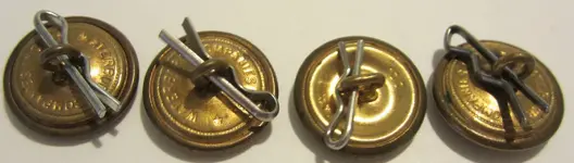

I bought 2 bags of small Great Seal of US buttons for a buck at a flea market. Can someone help me date these backmarks? I believe they are all post 1902. I cant find anything else online.
1- Top row SCOVILL MF'G CO WATERBURY (back ungilted)
2- SCOVILL MF'G CO WATERBURY
3- Bottom CITY BUTTON WORKS - N.Y.
4- WATERBURY BUTTON CO.

Waterbury backmarks.
WATERBURY COMPANIES INC. * is WWII era and after.
WAT CO. unknown variation.
Umm... no, WATERBURY COMPANY INC * should not be after World War 2 -- as proven in another thread. By the way, the button-backmarks in the photo you posted (just above) with that statement say Companies.
It was a typo. The buttons are WATERBURY COMPANIES INC. * thanks.
