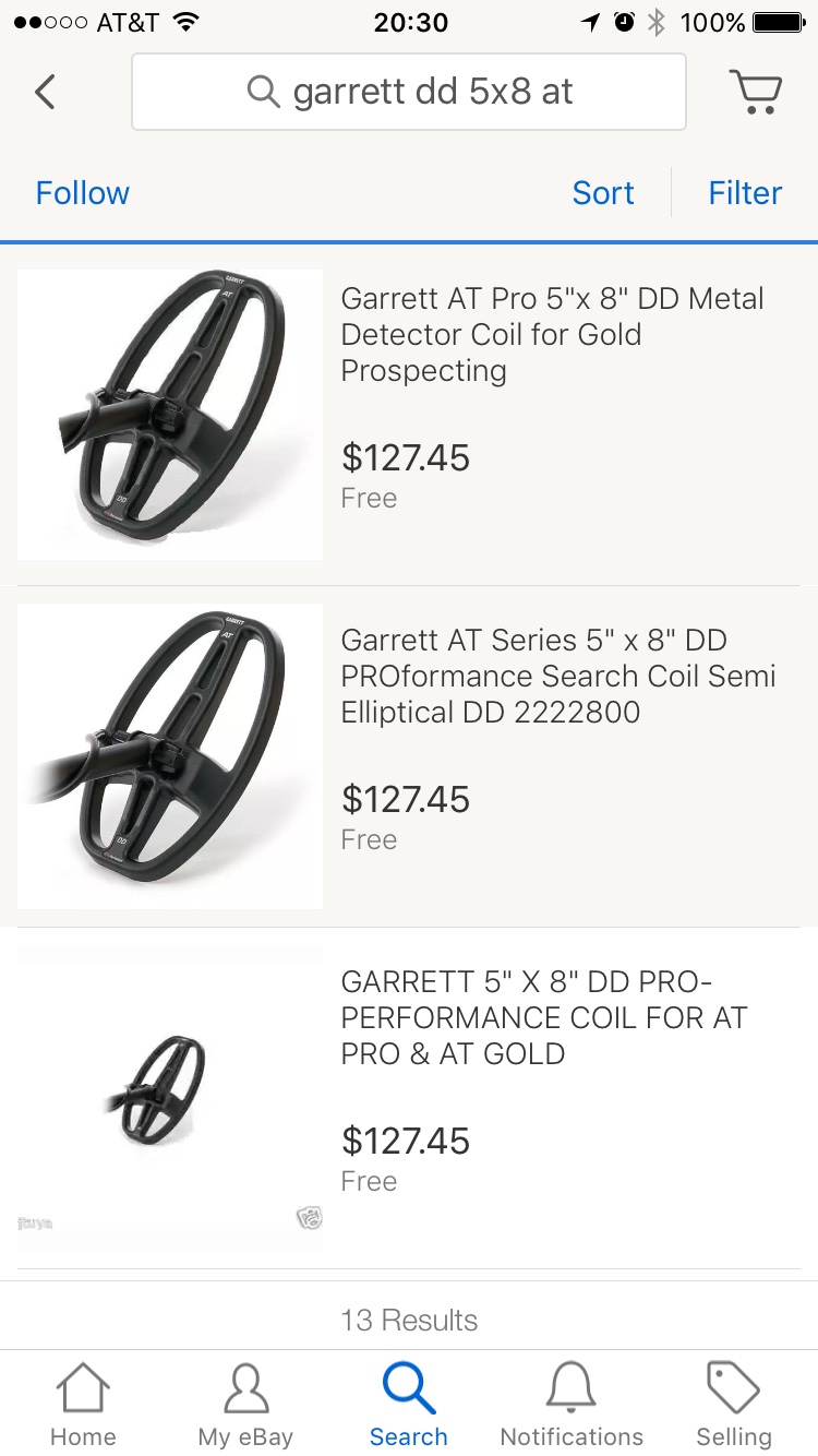

Is there a difference between the one that says "for gold" as shown below? Thanks
Nope. Same coil.
Great thanks!
Mine lost depth with smaller coil. When I read they get same depth I sure didn't and it doesn't make much sense.
jadocs - the factory AT coils are interchangeable between the AT Pro and AT Gold, that's why you are seeing them advertised that way.
Thank you, that's what I suspected...I'm pretty new with all of this so I wanted to make sure.
