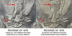

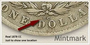

Ok I did a little searching on the web and this is what I found.
I won't say this is real or fake.
I will leave that to be decided by a certified coin dealer with the coin in hand.
First off this coin has the 1879 reverse. I'm not sure that this exists.
Second the "CC" moves around. So this coins CC could be in this spot.
I have Morgans with the same look to them in my collection, so not an unheard of look.
I would love to be able to hold this coin in my hands to help with my conclusion.
Here's some pics of my findings...
