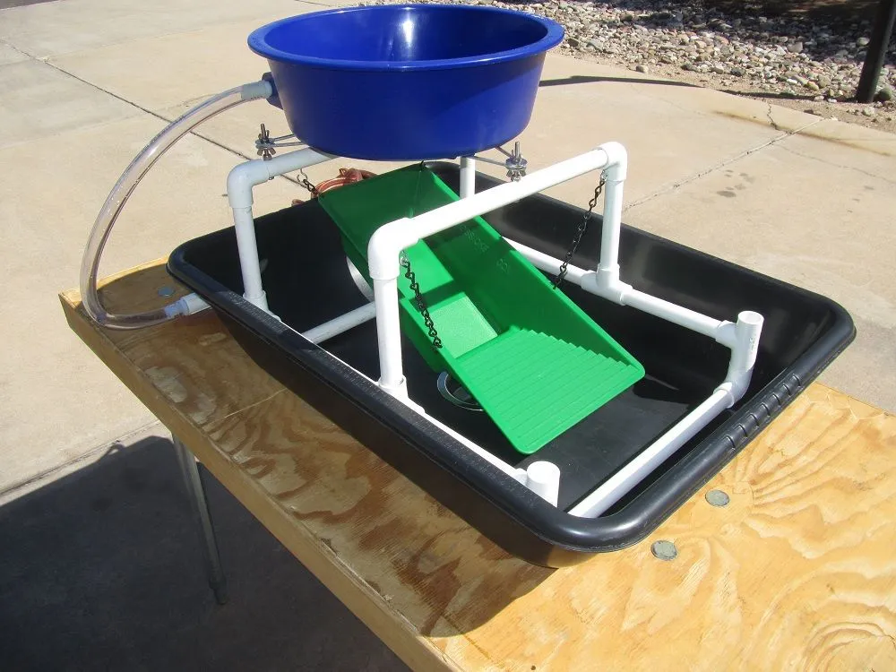

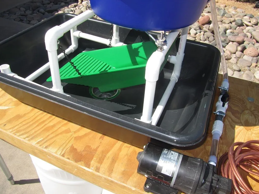

This is my fine gold recovery system. Thought this would be easier than using a 5 gallon bucket. As you can see I have a leveling system to level the center cone as this is very important when using a blue bowl, simply place a level on the top of the cone and level the bowl both directions. I am using a Fossickers Gold Pan as a small sluice to capture any fine gold that I may lose while learning how to recover gold at different size concentrates. Yes the Fossicker gold pan is overkill but it can be removed easily and used as a pan if needed. The raised drain keeps the concentrate contained within the black tub while keeping it from entering the recirculating tanks. The pump in the photos has been replaced with an Atwood submersible 1200 GPH pump. The first video shows the entire system.

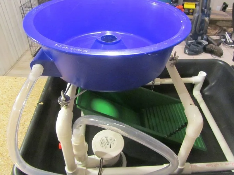

Jim I did make one slight change to the mounting of the Blue Bowl. I rotated the Blue Bowl so the inlet was parallel to the rear mount. This placed the center hole of the Blue Bowl more to the top of the Fossickers pan. When I ran the system the water dumped onto the riffles. Now the water dumps closer to the top of the Fossickers pan. If any gold is lost out of the Blue Bowl it will be caught at the bottom of the pan before the first riffle. I will post updated photos soon. Thanks for the comments.

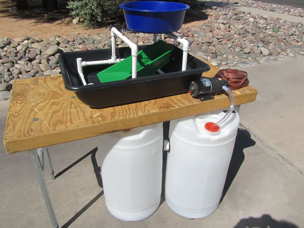

As mentioned above I have rotated the Blue Bowl. In the photo you can see where the light is now casting on the Fossickers Gold Pan. I have decided to add two 15 gallon barrels to the system. One of the barrels will collect the discharged water/concentrate while the other barrel will supply fresh water. A 2 inch PVC pipe will be installed between the two barrels.
I did run the system and while trying to figure out the water height on the Blue Bowl and lost gold out of the Blue Bowl. But the Fossickers Gold Pan did as it was designed to do and recaptured the gold that had spilled over the center cone.
