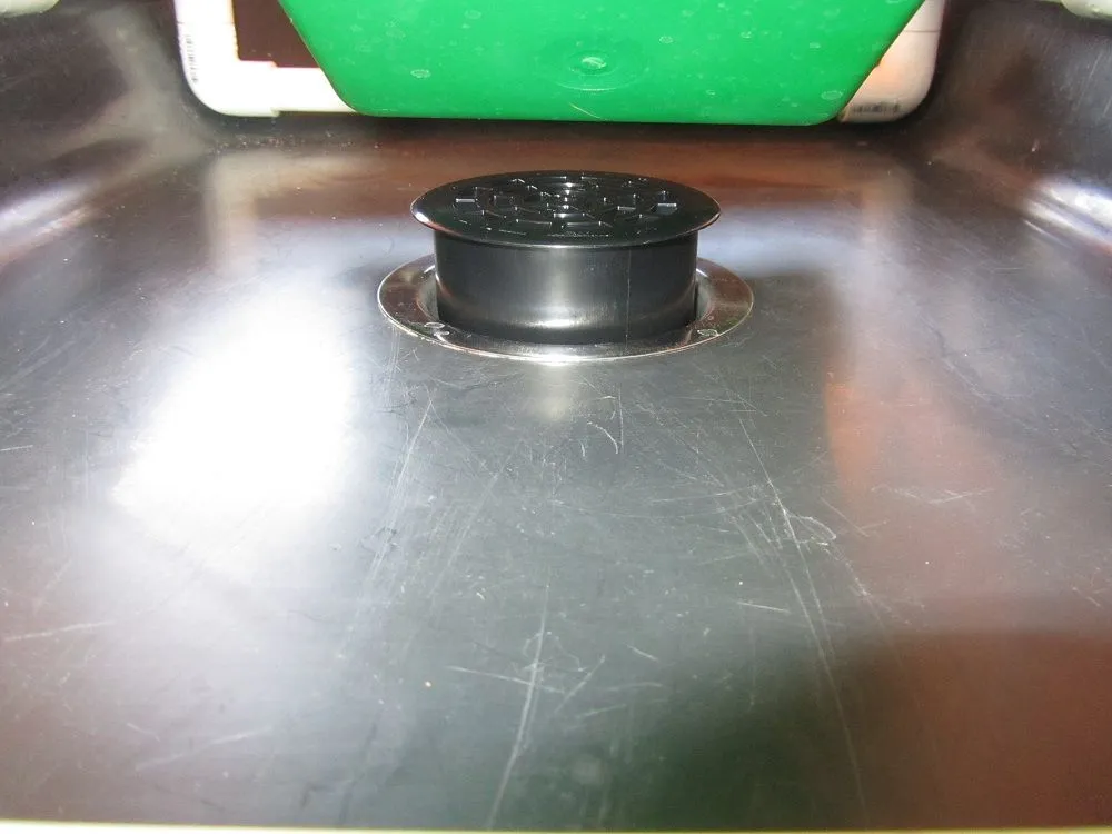

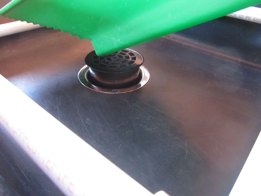

Jim this system keeps evolving and I have had to make changes. I added this raised drained to keep all the concentrates from going into the barrel below this helping keep the water cleaner and easier to clean up. Found a rubber o-ring to go around the plastic drain and the (o-ring/plastic drain) fit tight into the the metal drain. Also I have to move the pump from the table. Way too much vibration in the blue bowl making it very hard to see the bottom of the blue bowl. I did run the system yesterday and had made a video to post but my memory card is bad on my camera. If I go over 10 minutes the video becomes corrupt and not watchable. I did recover gold as I ran 50 mesh concentrate.
