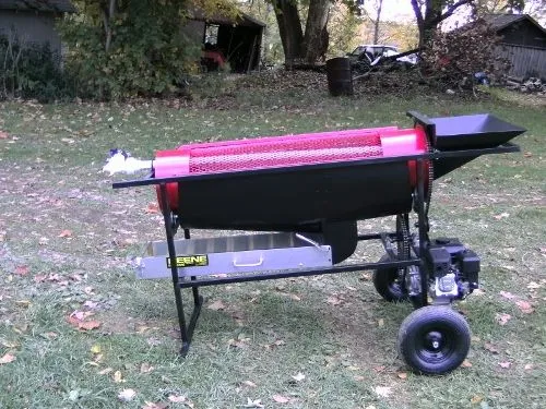

I HAVE BEEN BUILDING THIS NEW TROMMEL FOR MY 74 YEAR OLD MINING PARTNER. I'M ABOUT HALF WAY THERE....

Hey another nice job. Just one question, is the drum spinning a little to fast? Maybe it was just the vid.
Hefty
Jog you did very nice on the trommel but i also think its running to fast! and 1 hll of a deal for a friend!now thats friendship!SALUTE!
Hefty
Was going to say the same thing. Maybe it'll slow down with some weight inside.
Looks like quality work.
"OK"
You guys just had to make me go check.... I did the math and put it together but I never did a real test after it was done. I think what your seeing is the space between the screens as it turns. It makes it look fast, I tested it and I'm right at 40rpm but I have to agree it does look fast in the video.The last trommel I built I made it with one screen, this one I did diferently and made 4 individual ones.

Jog, I know I'm about a year late but wanted to say that's an awesome trommel you built! Better than any commercial one I've seen. I'm new on here and I've been looking for anything and everything on trommels to get ideas for building mine. Yours tops them all! Do you have any plans posted on here or for sale?

OK... What I did for the drive gear was found a sprocket big enough that I could cut the center out to fit the screen, then bolted it on to some brackets that are welded to the screen. I found a sprocket at www.surpluscenter.com for my 12" trommel build.
The part # is 1-1980-72 that is a 50 pitch sprocket and the outside diameter is 14.69". I had to cut the center out to the size I needed.

His is like the picture but definitely better! I like how he put the spray bars on the outside on the new trommel. He did that after a big rock broke his pvc spray bar inside the trommel. They're metal and look like aircraft hydraulic lines. Great idea and they're light weight.

I can make those rocks stay in the drum all day long if I want, just by changing the angle of the the drum. "Yes" the first attempt was two fast but the second one I built for my friend is turning right at 40 RPM and it is a gold grabbing machine. A while back he had a couple of young guys working it and they blew through 342 5 gallon buckets in a day and it didn't skip a beat. They got some great gold.

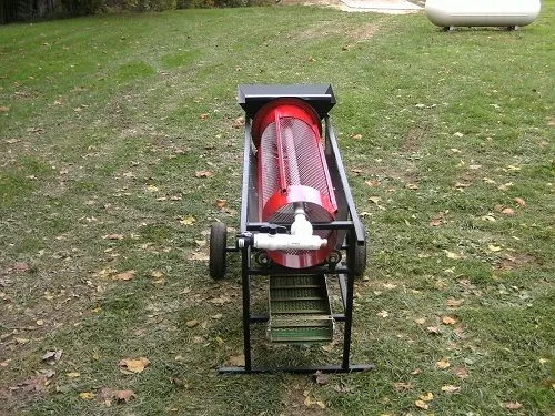

Nice build. Mine runs the spray bar through the drum. PICT0194.webpPICT0193 (500x375).webp
I don't think its the spray bars, i think its the trommel drum. He made it different from the first one. It doesn't have one big open screen. Its like taking a drum and cutting 4 or 5 long sections out and welding in screen. So when the drum is turning the water is spraying inside the drum most of the time but not all of the time. So when it turns it sprays through the screen then it sprays on the outside of the drum then the screen then the drum. You get the idea. I believe that's why he doesn't like it. With the drum built the way it is the spray bar should be on the inside. He has another video of the same trommel all done and painted. He shows you how easy it is to take apart. That's when you can see how the trommel drum is made.
I like his idea and will be building mine with the spray bars on the outside. If I find it doesn't work that well then I can easily change it and if I do it will also be metal tubing inside so that it doesn't break like pvc.

"When watching the videos on the two different trommels I made two different types of drums. The one without the oval holes works much better and was easier to make."
