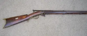

It doesn't seem to have any identification or serial numbers. I was told its a ladies rifle. Its a cool lightweight cap and ball type muzzleloader. I believe it to be authentic. It might be .22 caliber or .25. Check out the hammer and nipple on the bottom. The only marking I see is hand stamped "A.STORY VT."
Any idea what this is? Help needed from the antique gun people. Thanks

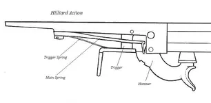

Im reading everyone's posts thanks and I will reply when I get a chance. I just got on a big screen and noticed the Hilliard in this link has my octagon to round barrel! This is the first time I saw a matching barrel. Im out of data so my computer is very slow.

I don't know if you've come across these sites, the first one has good pics of a known Asa Story rifle
A Story Underhammer: A Story Underhammer Rifle
This one is the Vermont Firearms Museum, they have an underhamer rifle on the slideshow here that has some pretty close similarities to yours
https://shelburnemuseum.org/collection/vermont-firearms/
Maybe contact them and see if they can help you authenticate it
I commented on the blog in the first link a couple days ago.
Thats a pretty gun in the slideshow. Being in Vermont, they might be able to help. I can send them an email. thanks.

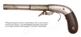

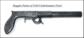

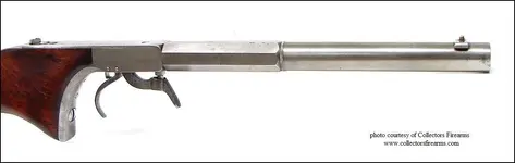

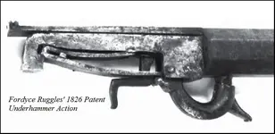

I found my barrel on 3 different underhammer pistols. The Underhammer Society

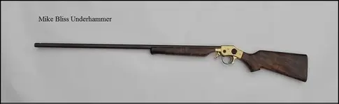

From the underhammer site. This may explain why the Asa Story has no ramrod. Its a target rifle.
http://underhammers.blogspot.com/2015/08/blisss-bliss.html?m=1
"It must be explained that the Bliss Rifle was not fitted with a loading rod as it is intended for target work only. So, the extra bulk of the ramrod is not necessary, nor desired, as he will be using a range rod for loading."
